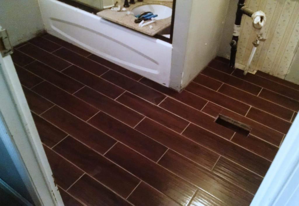

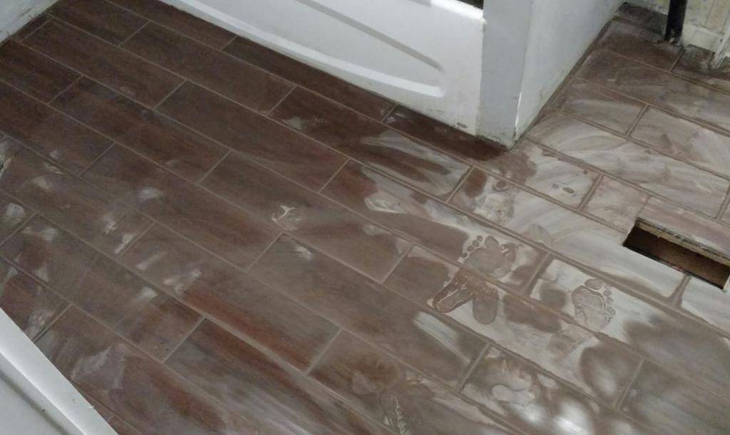

    Got the floor down, but I screwed up and learned a lesson in grout. I think I cleaned it too soon and used too much water, it lightened up pretty bad after this photo, everywhere except the corners where I didn't mess with it much. Picked up some Aqua mix seal n enhance yesterday and tried a spot, seemed to help out some. Going to seal it all tonight and hope for the best. If I can't deal with it, I guess I get to cut it out and try again.
    New pex plumbing everywhere I could get to, new insulation down below, and ended up returning the OSB in favor of some 23/32 BC plywood. Father in law came down to help me install the board and tiles. Now we are on the hunt for a new vanity, and next project will be removing the shower liner in favor of a tile wall. Part of me still wants to remove the tub, divider wall, and do a 100% tile shower.

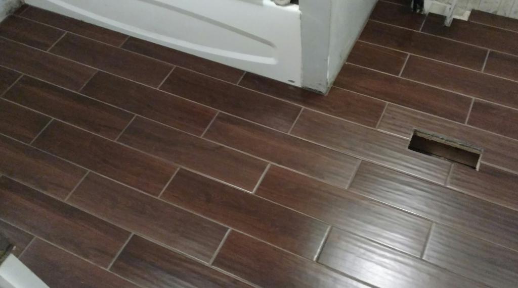

      Here's after another wipe down to get the haze off, grout was about 24hours in and shows how light it got. It is even though, lighting makes the one spot appear much worse.
                    I installed those exact same tiles in the house we just sold and experienced the same grout problem. I suspected I used too much water when wiping down. I dig the wood plank look!

                        I appreciate the kind words but I can't take credit for the tile work. Let the pro lay it down and I kept cutting and feeding them to him.
                        Sealed the grout with aqua mix enhance/sealer. Happy with the results so far, let's hope it holds!
                        Lesson learned. More setup time and less water!
