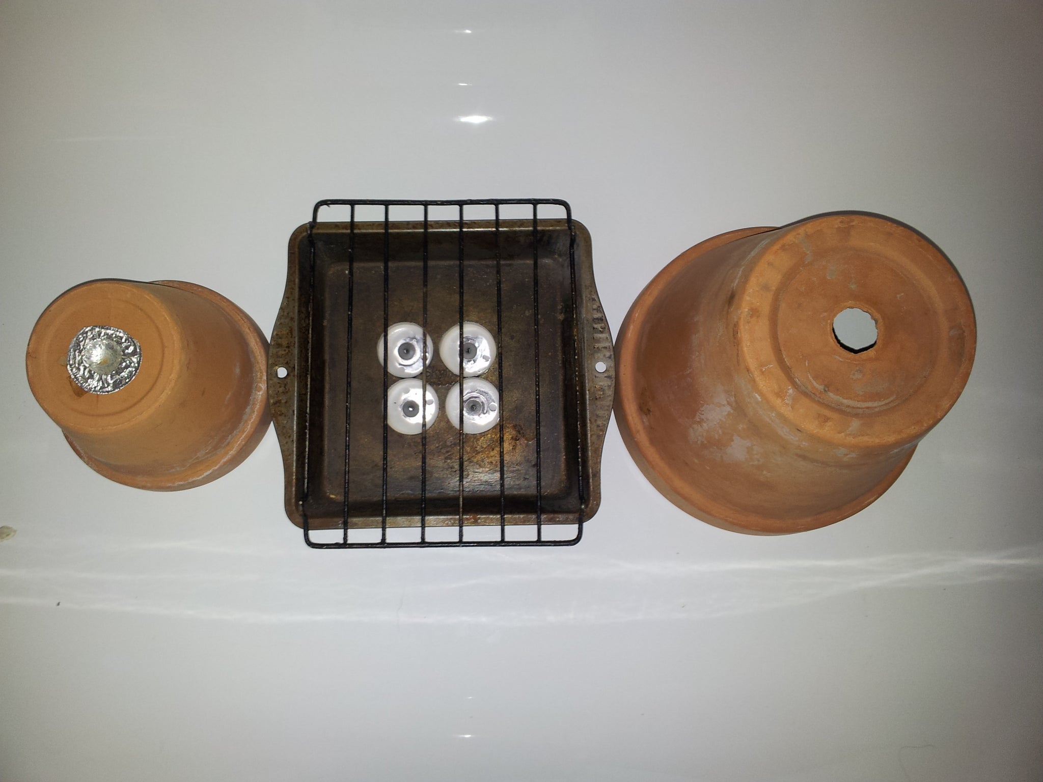

                            Flower Pots & Tea Lights Heater: I found this in a review and had to try it out. A room heater made from a small roasting tray and its trivit two clay flower Pots 4 tea lights and a scrap of aluminium foil
