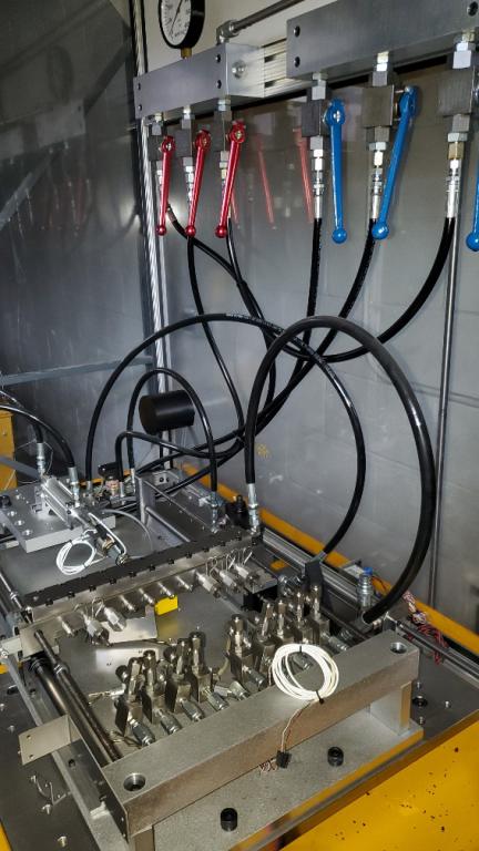

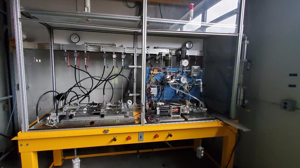

    Anyone know what these are?
    My company is demoing a robotics facility, and these two devices are in the old machine shop building. I think it has something to do with hydraulic fluid filling or something. Just curious what it actually is, and if it's worth anything, otherwise it's getting junked

    Super hard to tell, which means it's probably something custom built for a job they ran there, which essentially means, it's worthless as a whole, but I see a fat servo motor there. Those can be worth some cash depending on the brand and if the driver is there with it.

      Yep, but there are probably a few grand in components there, at least in used value to someone.

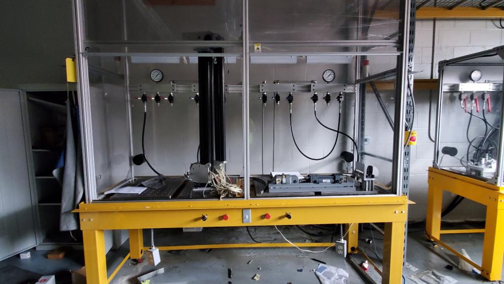

        Looks like hydraulic test stand....to test hoses, valves, pumps or provide precise flow for testing etc. What was the business?
          Robotics - automated material handling, I think it's an old Vecna lab.

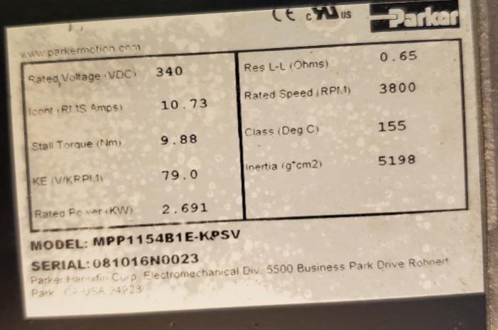

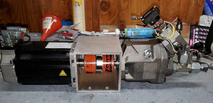

            which piece is the servo, I can go take a look at the model if I know where to look

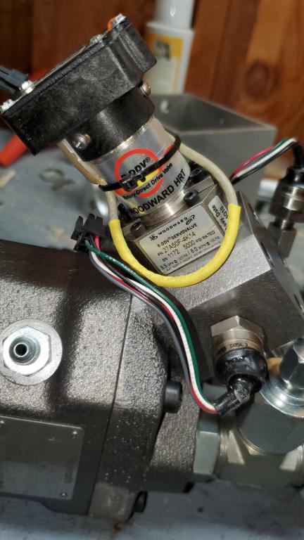

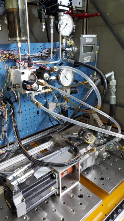

              Servo is the black box with 2 connectors and yellow triangle sticker, last picture, bottom of the pic. It’s definitely testing or some sort of educational stand where you can assemble different configuration

                Looks like a test or calibration stand for instruments, valves, servos or some other expensive item.
                  parker mpp1554 is what I found on it

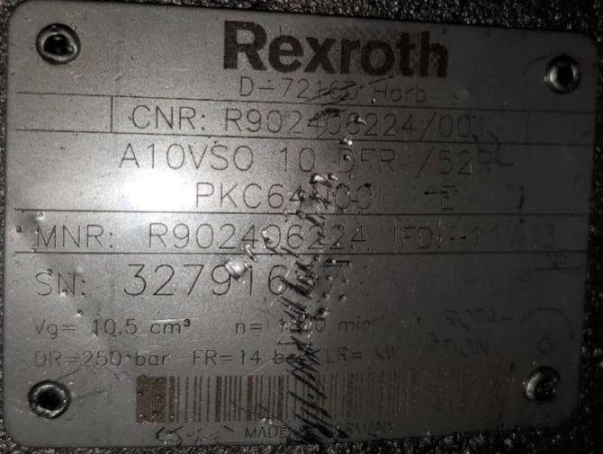

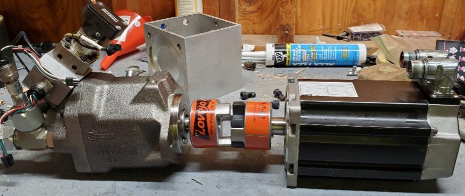

                    Can anyone "appraise" this set-up? These were what I was able to salvage from that whole rig in the OP. Where would someone go to to sell this kind of equipment? Is eBay my best bet? Anyone know any specific forums related to this stuff that might be better than eBay?

                      Okay, so referencing the first pic here, you want to detach that orange coupling from the servo shaft.
                      Then, you're going to want to get those two cables with the connectors, trace those back and grab the servo drive they're attached to, or should be attached to.
                      You need to sell the servo, the two cables and the drive as one kit.
                      As for the price, idk, you'll have to look online.
