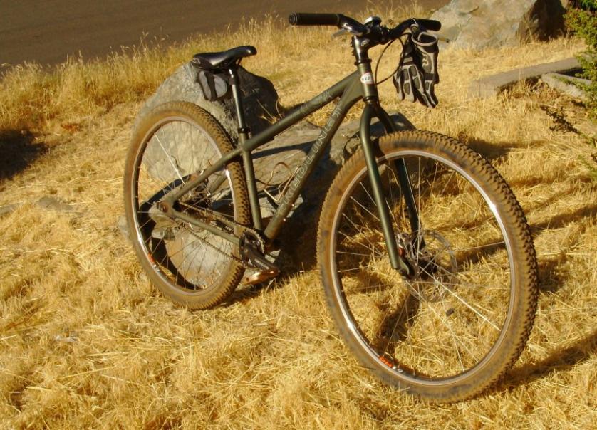

            taking a break
            My current favorite bike, a Redline 29 monocog, with big discs. This thing hauls ass. It is a very fast bike, and takes very little getting used to. I try to ride it 4 miles a day, but at least a mile for a quick break if I'm busy.
            I absolutely refuse to say "29er". Thats like saying "3er" instead of e30. I don't want to be one of those guys.

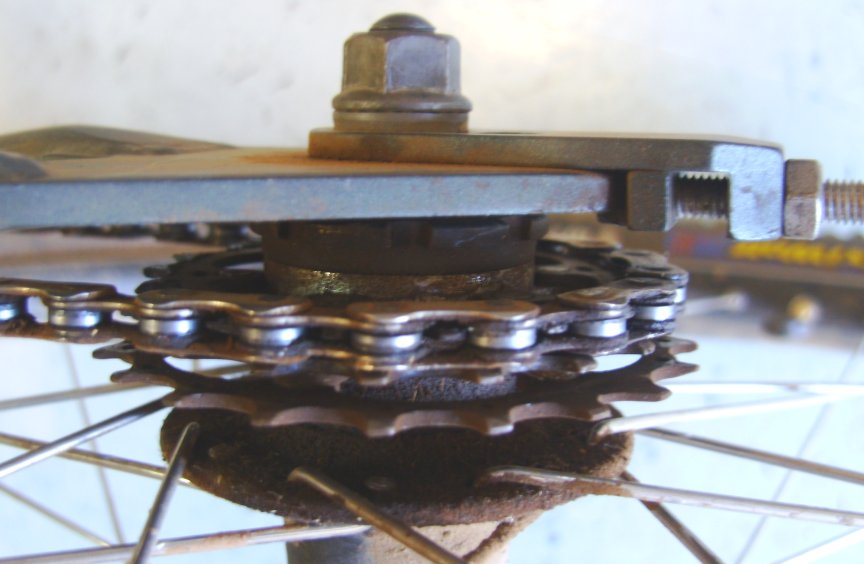

              Here is a technical idea for the single speed guys who like to stop pedaling every once in a while to go through a creek, and may help out some fixie urbanites too.
              I disassembled a Shimano 9 speed freewheel, and the sprockets are 3+3+3. With some machining, I was able to do this.
              I had to go to a 9 speed chain, and incidentally I broke a regular one right away, so I had to buy an expensive chain.
              When I am going somewhere that is a lot of climbs, I just put the chain on the top or middle with a 15 mm wrench (a 29 with a strong guy cannot use a QR axle, in fact the tensioners are mandatory) before I leave. There is no derailleur. This works especially well if you are going so fast on the downhills that you don't pedal anyway. I usually carry a cut down 15mm wrench that would still freak out a roadie gram-hater.
              The sprockets are 17-18-19, and the disc brake can handle the front to rear misalignment because the caliper is directly above.
              99% of the time I have it on the 17 anyway, but this is a neat option for a Single Speed bike that goes different places.
