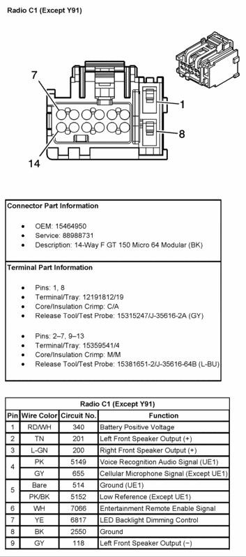

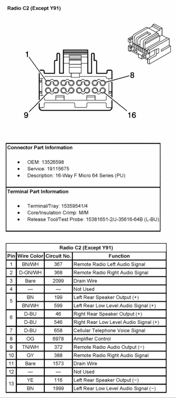

                        Yeah this thing is a bit confusing. The way this is setup is you unplug the stereo, then plug this deal in between the stereo and the wires that should go to it. I have two ISO harnesses for it, one has all the F/R L/R wires for it, and the other has the 12v, ACC, etc on it. In addition I have the two line inputs (which go into the stereo then output to the front to speakers). I don't get why I have a harness for all 4 speakers. All I really need is power, acc, and the mute line. It would appear that the other harness for the speakers does nothing except extend the cable.
                        Here is a pic I found on ebay on the back of it
                        I am pretty sure these are the correct pinouts I got off alldata:
                        Whats the lowlevel outputs mean? Like they have RR Speaker output + and then RR Low Level Audio Signal +
                        I think if I could just find the C1 male harness that would work, it has all the outputs I really need.

                          Originally posted by equate975
                          your pm box is now full ;) Heres what I was gonna reply with lol
                          Oh cool, so you could run this thing into an amp using the low level outputs, or use the little amp built into it...schweet!
