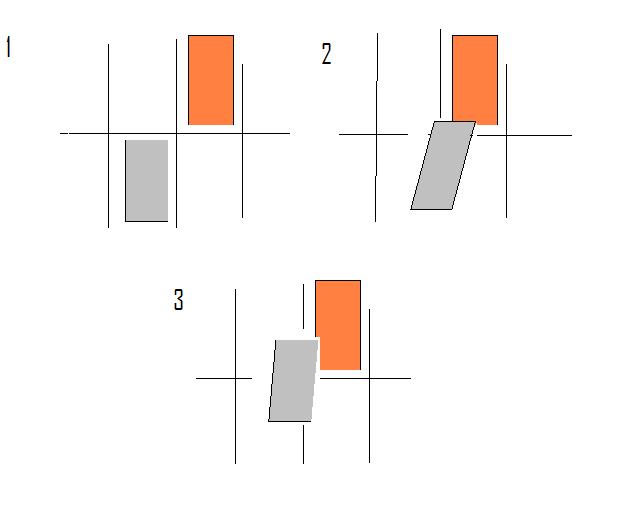

      Professional experience says it was a hit and run. I am not however sure what hit your car but I am working on a quick illustration of how it went down. Dont rule the psycho out as the person who hit it. I need a picture of the right front and left rear tire and the asphalt underneath said tires to be sure (scrub marks). Dont be silly and jump to conclusions the lack of paint transfer is odd but not that unusual.

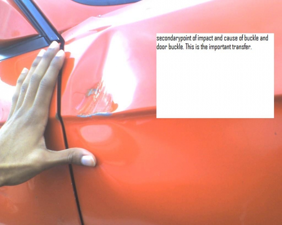

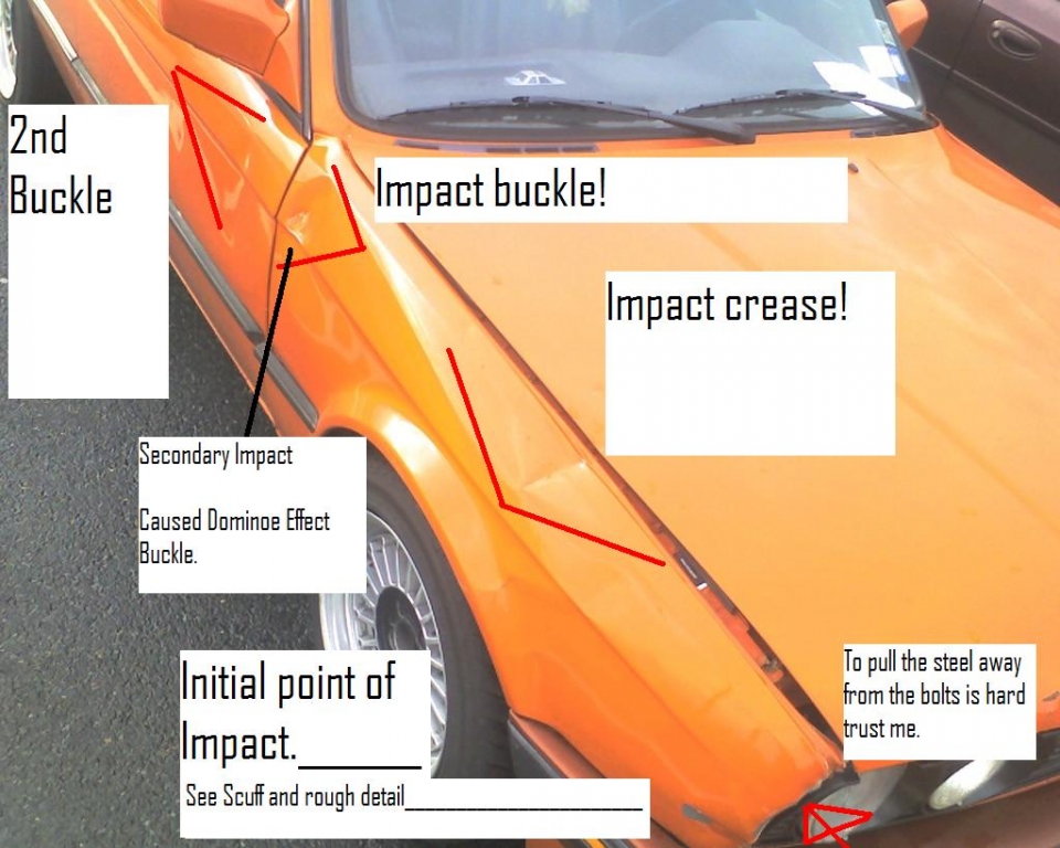

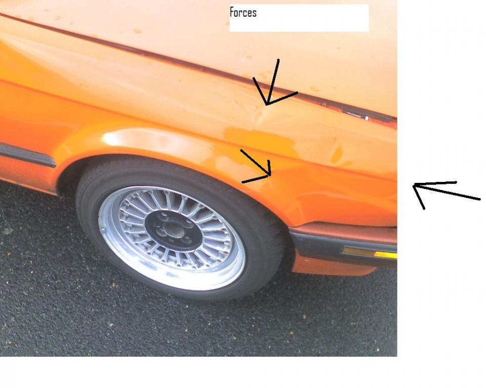

          Here is what I can see in your pics
          I am unsure if you had ant front end damage before this but if you did not here is what I see. The initial impact came to the front feder just above the bumper, causing the body wrinkle and the impact crease. Also it tore away the fender from the mounts (that is way beyond human force). Then the person pulled away and backed into the car again more likely than not in an attempt to make a hasty get away (drunk). The second impact carried the pressure from the fender accross the body gap and contacted the door skin causing the wrinkle inthe door skin (very easy to wrinkle the door skin)
          Good luck.
          You are correct about this scuff or transfer it appears downward in nature but sometimes that is caused by the shape of the body panel and entry and exit angle of the impact. If you scrapped the steel you would probably find clearcoat on the steel and the paint can be matched to a vehicle manufacturer.

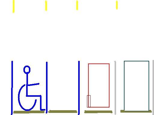

              Here is a rough sketch of the area where my car was parked. Keep in mind that those handicapped parking spots are seldom used. I also highly doubt that there was any activity over the weekend as there were no events on campus during the weekend so im ruling that out.
              the burgundy box is the area of damage
