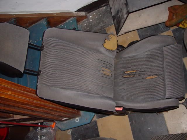

    Life in europe has been pretty tough for me, the over taxation of my welfare check paired with the government nationalizing my family hemp farm forced my to get creative to make ends meet. Since the government owned e30 parts store didn't have any sport seat bolsters, I made one work from a std. flat seat:
    Busted sport seat:

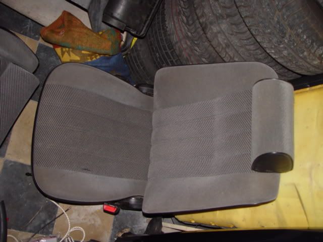

    decent flat seat:

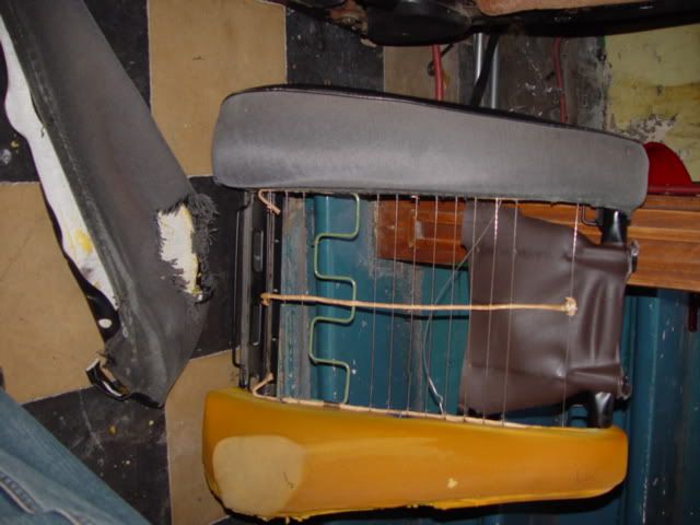

    take it apart (had taken out the center section, but didn't have enough cloth to make it work)

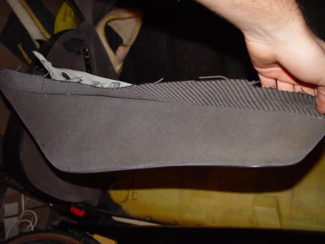

    std bolster cut with about 1.5" extra cloth:

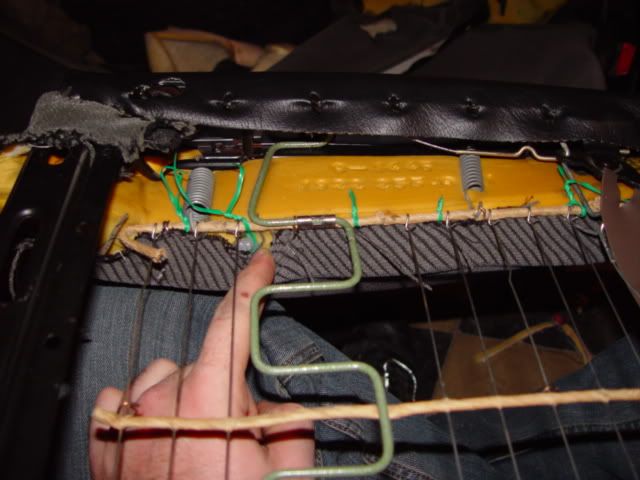

    New bolster is attached to seat via original vinyl holes (back side) and plastic tabs+ factory clips around extra cloth.. :
    (right by my finger you can make out one of them)
    Get it nice and even and it'll work out.

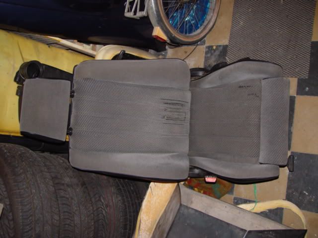

    It doesn't work out perfect, but is a very nice improvement.
