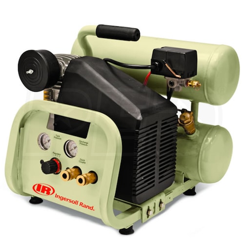

                              Here is what I landed on:
                              Buy Ingersoll Rand P1IU-A9 Direct. Free Shipping. Check the Ingersoll Rand 2-HP 4-Gallon Contractor Twin Stack Air Compressor ratings before checking out.
                              4.4 @ 90lb
                              Ordered last night called today to see what the processing time is they said it ships from IR, had been on backorder for two months and is expected to ship in 14-21 days :(
                              Found a local IR center going to pick it up for the same price plus tax.
