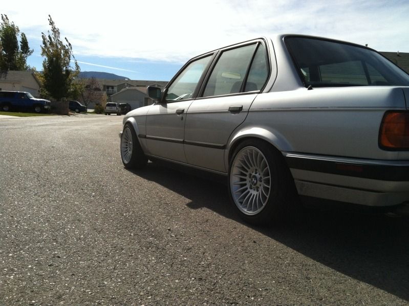

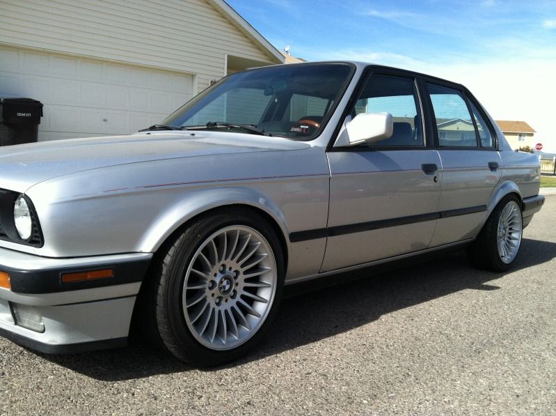

    Yes or No..? e38 20 spokes
    Im border line Mirin' Going for classy and subtle daily status.
    What say you r3v?
    Specs
    16x7.5 e38 20 spokes
    final offset et +5 all around
    18mm 42 draft design adapters
    205/45r16

    I dig it, I don't know why - but I do.

      Looks kinda like Alpinas I like it

        Looks pretty badass if you ask me!

          Nice look, classy, different than all the rest.

            If I saw the wheels off the car I would have said no. But they work well!

              Looks fantastic.

                good. very good.

                  Yes.

                    They look sick.

                      what suspension are you on?

                        oh ya forgot to add.
                        JOM front (no camber plates), not even close to all the way down. GC 6in 2.5 rear springs
                        Also. front and rear fender roll. No pull. I thought I might be able to go 20mm adapters in the rear but 18mm is best.

                          Hell yeah.

                            yesssssssssss
