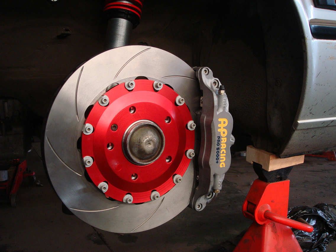

                              I wanted to gain info on your brake and suspension setup... Those look like massives but I wouldnt know.
                              • Andreas
                                • Jul 2006
                                • 107
                                #90
                                Originally posted by e30slut
                                hey, saw the vid of the accident. Glad it happened there and not anywhere else like you said. scary stuff
                                I love the build and this is a great thread.
                                Thanks.
                                No the brakes are not from Massive. It is a custom AP Racing setup for the front. 330mm x 28mm full floating discs with 4 piston AP Racing calipers and Performance Friction brake pads.
                                The rear consists of E46 M3 328mm rear discs and E46 M3 rear brake calipers with the standard brake pads for that car.
                                I've dumped the brake booster and installed a Tilton pedal box. Both the front and the rear calipers have their own AP Racing master cylinder and the clutch uses a Tilton master cylinder.
