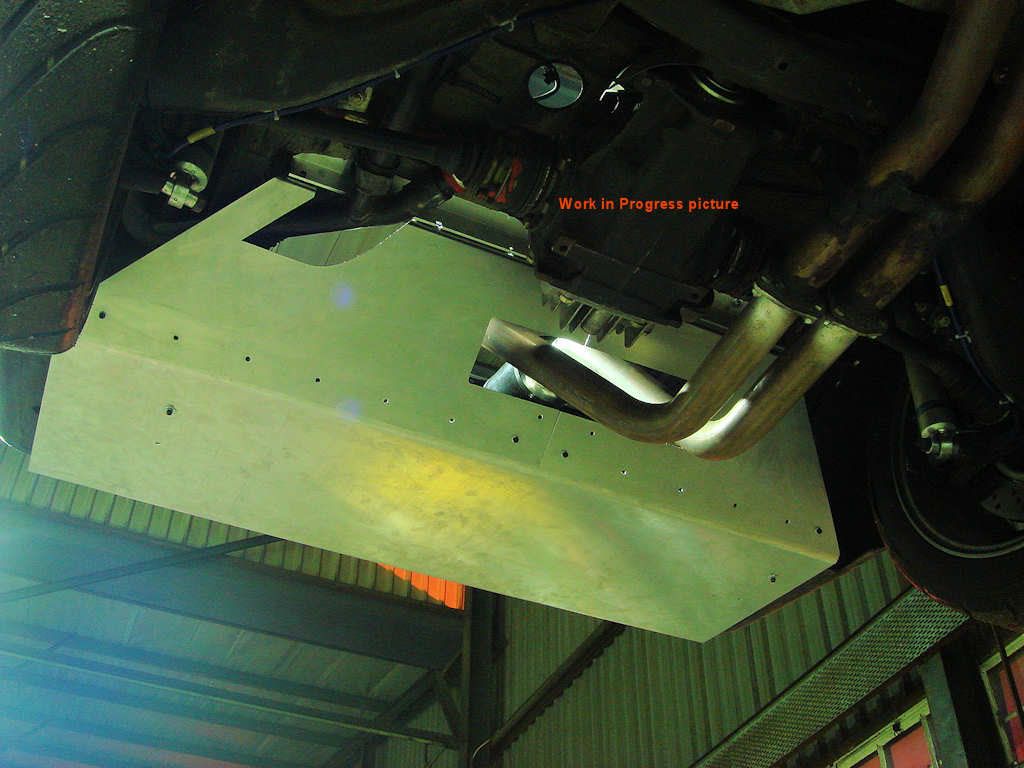

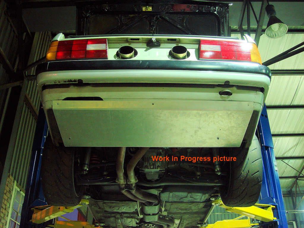

why dont you cut up into the rear valence to create a deeper diffuser? make the top of the diffuser the bottom of the trunk... if you follow me. the sides would the inside edges of the tubs on either side of the trunk.
Originally posted by vladDo you know anybody else who built that many bad ass E30s?Comment
I hardly managed to finish the closure in time for the race. It is actually not easy to mount something straight since there is very little symmetry on the body - the fact that the rear is a little bent on one side didn't help either.
I do understand what you are saying and wanted to do that but time was against me. One thing however also held me back from implementing that solution - the tubs on either side of the trunk extend by different amounts towards the middle of the car which would result in an odd looking off-center diffuser.Comment
you could build it to the larger side... the diffuser would not reach the smaller tub.
theres a lot under the car to work around, and unless you made the rest of the car 'smooth' it wouldnt work too effectivly.
