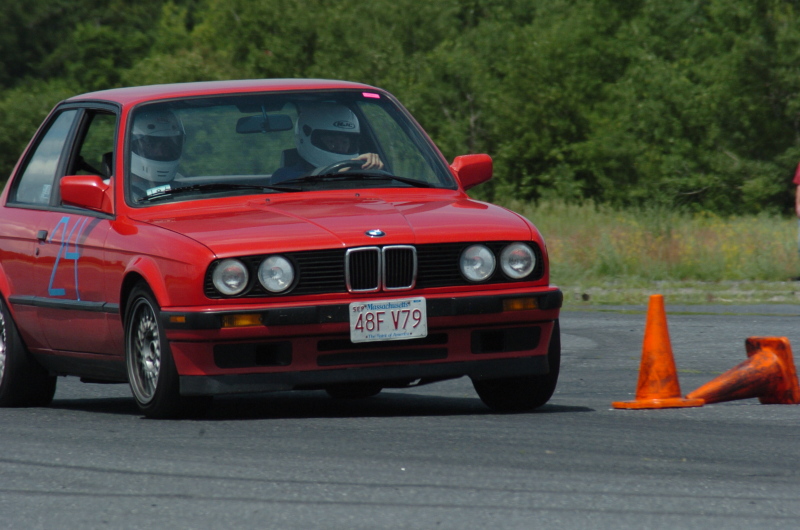

            fred was running j stock and his car didnt have anything close to the body roll i had.
                  Which Bilstein's do you have? Match rated or off the shelf units? What ones does Fred have?

                      Turner motorsports adjusted for h and r race.... They seem to workfine for jstock.... I cant speak for fred

                        Here's me at the same corner. I have J-stock and matching Bilsteins (not the Evo inverted shocks, though). Keep in mind, I drove a lot slower (:puppy:).

                            I forgot to mention, I do not have fuh raze swaybarz--just stock ones.
