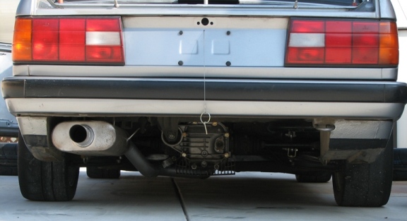

        Kaos, does that diff that's peaking out look familiar? It's the one you sold me. Works great. Thanks again. I agree that most of the noise is from wind hitting the rear. I'm planning on making some kind of simple diffuser at some point. Yet another project farther down the road...
        Makes sense about the tar out back being ballast and not just sound dampening, although it did do that too. I noticed the rear was sitting up a good bit higher when it was all removed. Not a big deal now though, car has been lowered. More mods down the road anyway.
                    Haha nice! I'm glad you're enjoying it. I don't think I ever knew your screen name because we mostly communicated by email. I'll be keeping an eye out for updates!
