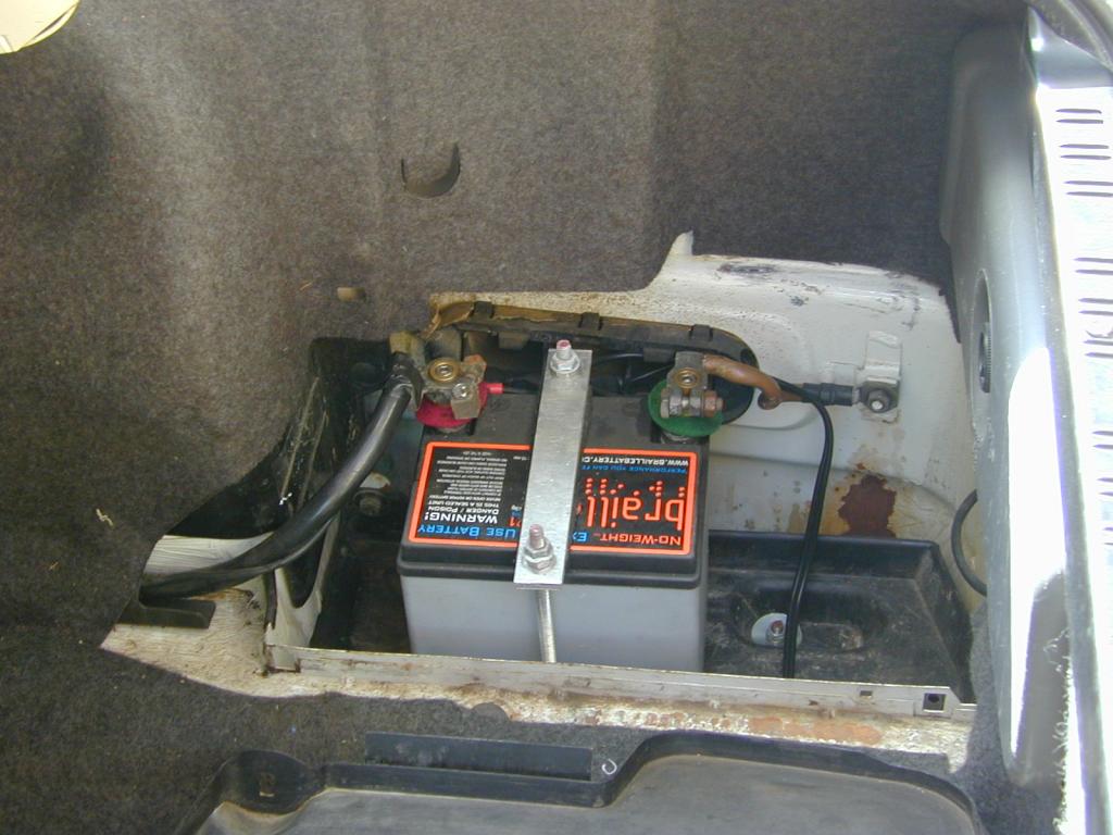

    I'm looking into a battery tie-down. What brands/set ups are you guys using? Pics would be great.

    1" ratchet strap. Never had a tech problem and, more importantly, never had a safety problem.

      threaded rod and some aluminum stock.
                How is the lower portion of the threaded rod attached?

                    Bottom of threaded rod has 2 fender washers and 2 bolts
                    550 CCA
                        550 CCA
                        http://www.braillebattery.com/index....teries/b3121/#
                        held in place by the plastic tray?

                              The battery is bolted to the tray and the tray is bolted to the car.
