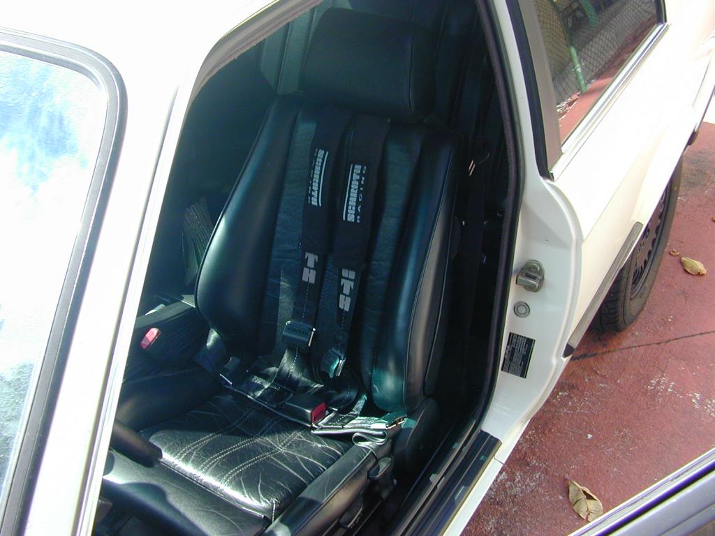

    I run Schroth 4 point "Anti Submarine" for Auto-X events. I still have the stock seatbelt for daily driving.

              I have run the Schroth ASM 4pts in my old E30 and loved them. They keep you from submarining (the nemesis of any 4pt), and they're really the only safe 4pts around. You don't want submarining.

                          Mine has the schroth 4pt asm ones I alluded to earlier and Dirtbleed posted a good picture of. They prevent you from submarining and allow your body to twist a bit to get out of the way of a rollover crushing roof. They're approved for E30 stock seats due to the seat back strength from the factory.
