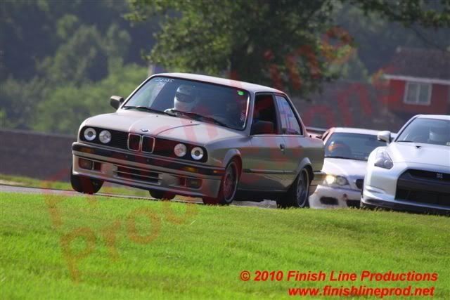

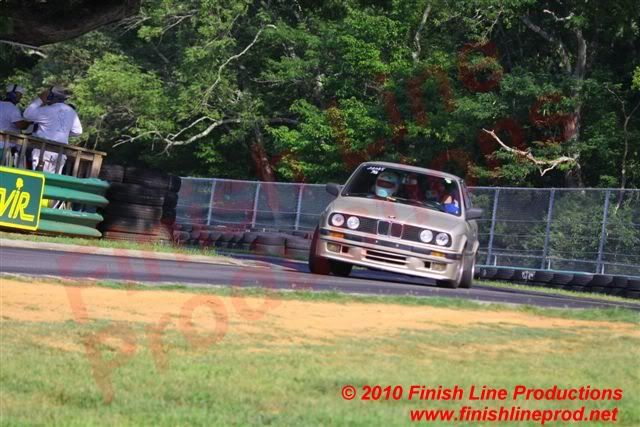

    Also, here's part of the reason for swapping to the SE30 setup from the soft-ish Eibach springs that came on the car - couple shots from VIR:
