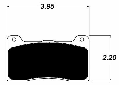

          Will HT-10's fit dynapro calipers? You wouldn't happen to have the p/n? I'm going to keep the BP-20's for street use and swap out to HT-10's at the track because they squeal too much once they warm up.
          • Massive Lee
            • Sep 2006
            • 6782
            The Dynapro uses pad shape #7812(12mm thick)

              dude3838, you're dennis correct? If so I met you at the glen (I was there with Jeff, your instructor, and had the spare set of dynapro BP-20's) If you want to stick with hawk pads check out the DTC-60, they're relatively rotor friendly (for a race pad), stop amazingly and hold up to abuse well (I was sharing the car with my father this weekend and one set of pads made it through the weekend for both of us).
              For purchasing, check out:
              Porterfield Brakes. Your one-stop shop for racing and performance brakes and parts. Shop our large inventory of Motorsports auto parts today.
              hit up racing caliper pad shapes > wilwood caliper pads > dynapro 7812
              that'll get you all the pad compounds they have available. Also if you're SCCA/NASA (I think BMWCCA too, just not sure bc I'm a member of all 3) they give 20% off on hawk compounds, so they're pretty affordable.
                      Thanks Lee!!
