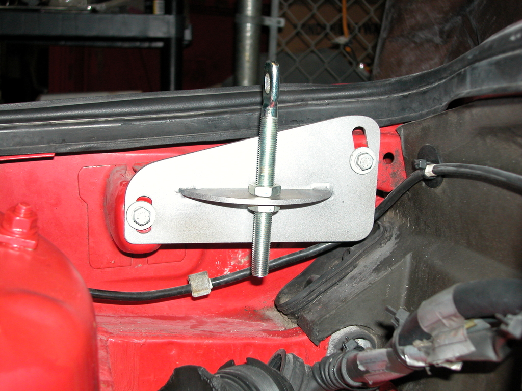

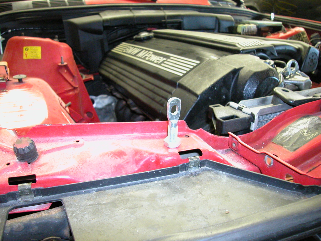

                      I've been using the rear sliders with front pins. My hood is pretty ridged so 2 pins hold it down just fine. After some off season hood hacking, I will re-evaluate my need for a 3rd front pin.
                      For the front pins I drilled through my core support and welded in a piece of tubing that extends completely through the core. I tapped the tubing for the same thread size/pitch as the pins. The pins are then secured with a jamb nut.

                      Closeup (sorry for the bad pic):

                        ^^^^^^Thanks for sharing, are you still using the OEM steel hood then?

                          mines similar to iflytii, stock hood using stock rear sliders and two aerocatch pins in the front mounted on the core support.
                            I have a VIS "carbon fiber" hood. It has all the provisions for stock mounting so the rear sliders still work well on it.
                            It's pretty rigid (thus the need only for 2 front pins) but it's also pretty heavy. It's going on a diet this off season!
