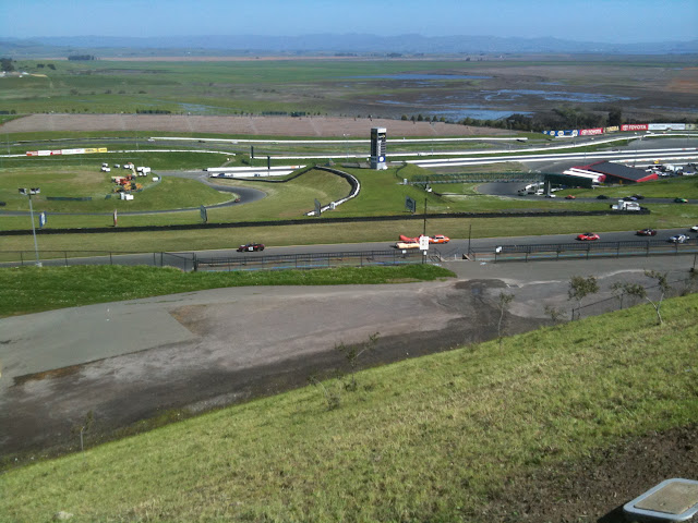

                              Originally posted by KenC
                              We're planning on running at Infineon/Sears Point in March.
                              Yeah, that's an awesome race. Hope you guys get in. We ran it last March.
                              Seeing an E30 do battle with a weinermobile on a world class track is not something that happens often.
