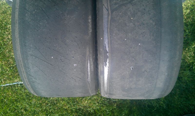

                    I'll keep you guys posted, I am currently looking for some bad/used 275/35/15s for test fitting the 15x10 wheel. I don't want to buy new tires mid-season, and realisticially only being able to run the last 2 weekends on them.
                    But, still going with this, just wait take a little longer as I am doing research and making some calls.
                    I have some I will give you just cover the UPS and its done. That gets you a start.
                    I killed them doing this http://www.flickr.com/photos/scott_r...7627118702032/ as they were last seasons tires and dead anyhoo. Let me know

                      Dude, i'll take them! Maybe fedex ground will be cheapest?
                      Can you give me a shipping quote to 95821 please, I want at least one if not both depending on cost of shipping from Utah.
                            Ya what I can do is like tire rack. Ill stick them together and mail them as one "box" Ill get a quote tomorrow or next day.
