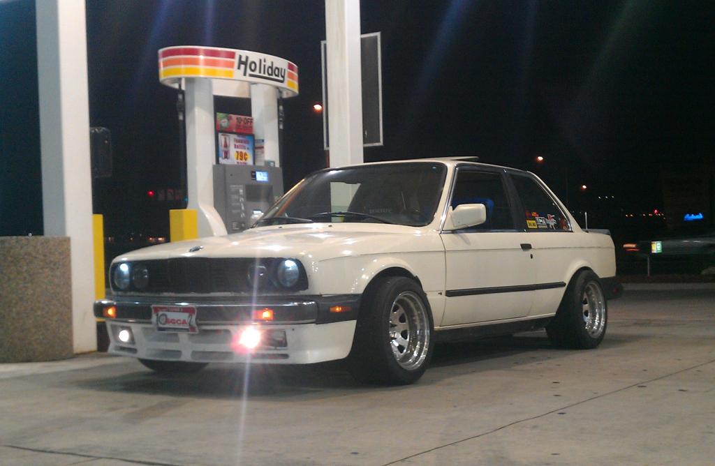

        I have been curious about these wheels as well. I run the 275 hoosiers.
        I think this wheel is like 5.5 ofsett with 10mm spacers
        You will need an honest 2 inches to cover the rubber and also trim the front and rear of the front fenders or as my friend did as he has plastic bumbers space them out a lil.

          ^ I sure hope Jean's car doesn't look like that! Looks like a Mexi-special.

            on one hand it looks kinda badass, on the other hand it needs some help! :)
            heh, I hope you were just filling up. I can't imagine how many street miles a set of hoo-hoos would get.. lol

                    Yes I drove home from an event cause the tires were dead. It was quite fun.
