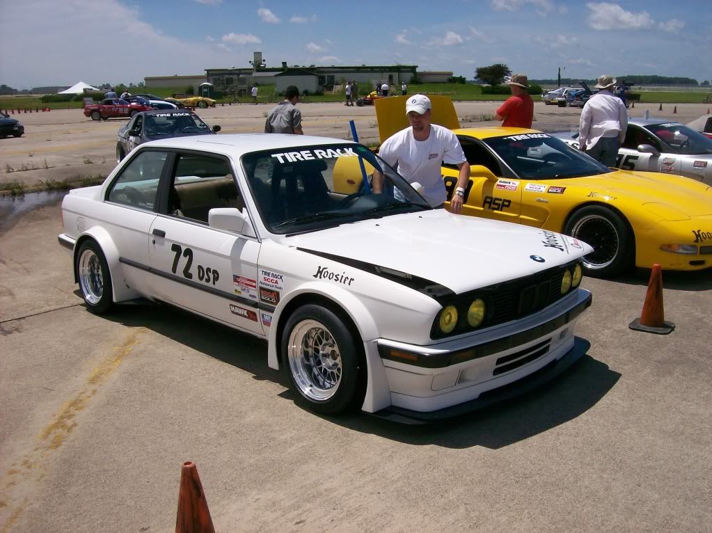

    Haven't ben to a large event in a whie, but can't say that I ever remember seeing anybody running an E30 with anything more than the stock spoiler.
    Dug this out of my old pics, IIRC this was Alex Shchipkov's old car? (I may be wrong) but no spoiler there.

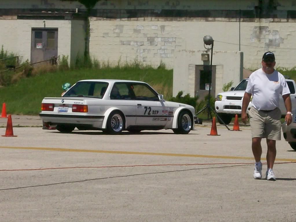

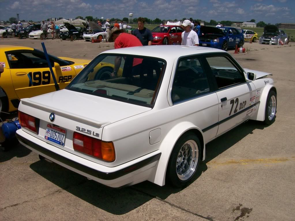

              Here's the only other pics I have of that car. Never met the owner, and don't really know anything about it except that I THINK it was Alex Shchipkov's old car. Anybody else have any information on this car?

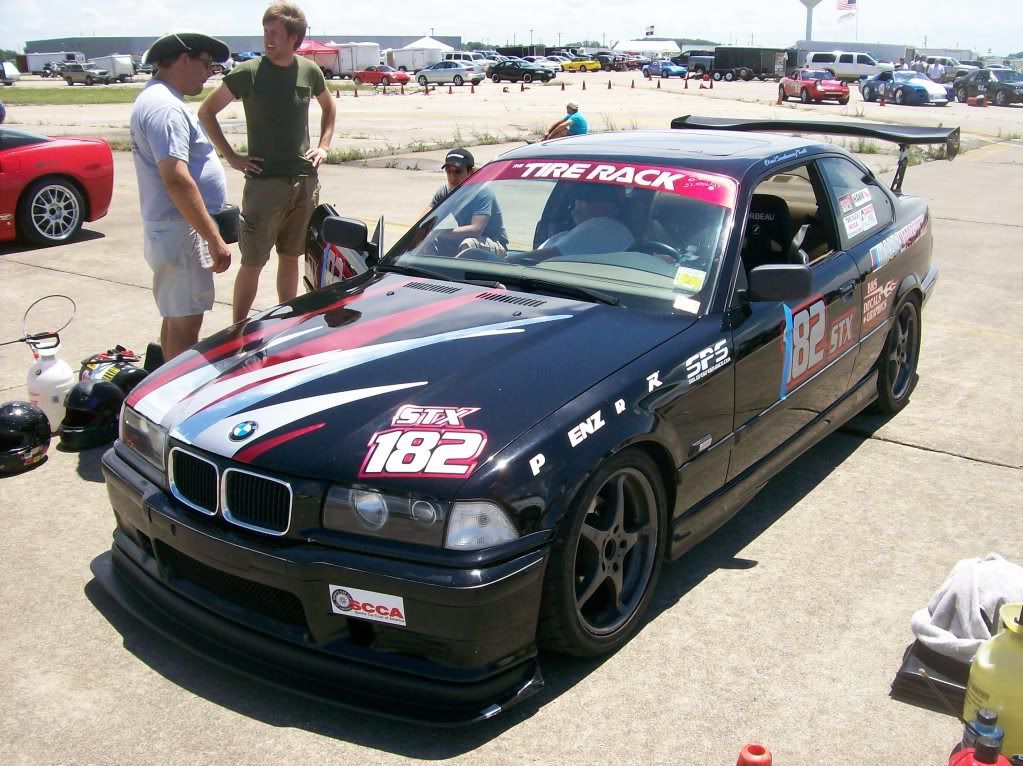

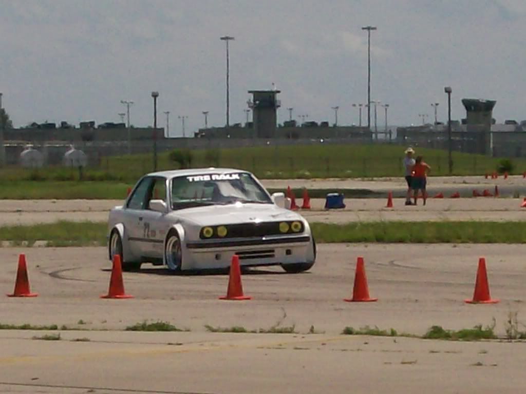

              To the OP, I don't know if this helps at all, but I also found this in my pics from the same event (Peru National Tour 2008 )
              • team9
                • 82

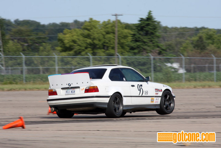

                This can be really confusing, but the OP is actually talking about a spoiler, and NOT a wing. SCCA differentiates between the two. A wing is what you see above ^^^^^. A spoiler is like what is below

                    Bascily you have to make a huge wall. I think 10 inches is the max. Look up Doug Rowse and his car. I recomend a spliter too. I made one for my car a while back but it was just a carboard template. A guy here local has one on his E36. He put it on with those nuts you crush when they tighten.

                          yeah. Technically a spoiler can't have air flow under it. and a spoiler is the maximum allowed in street prepared. Yes 10" out of the bodywork is maximum allowed.
                          I've picked up lexan for the project. it should be... interesting.
                          that e36 is ridiculous.
