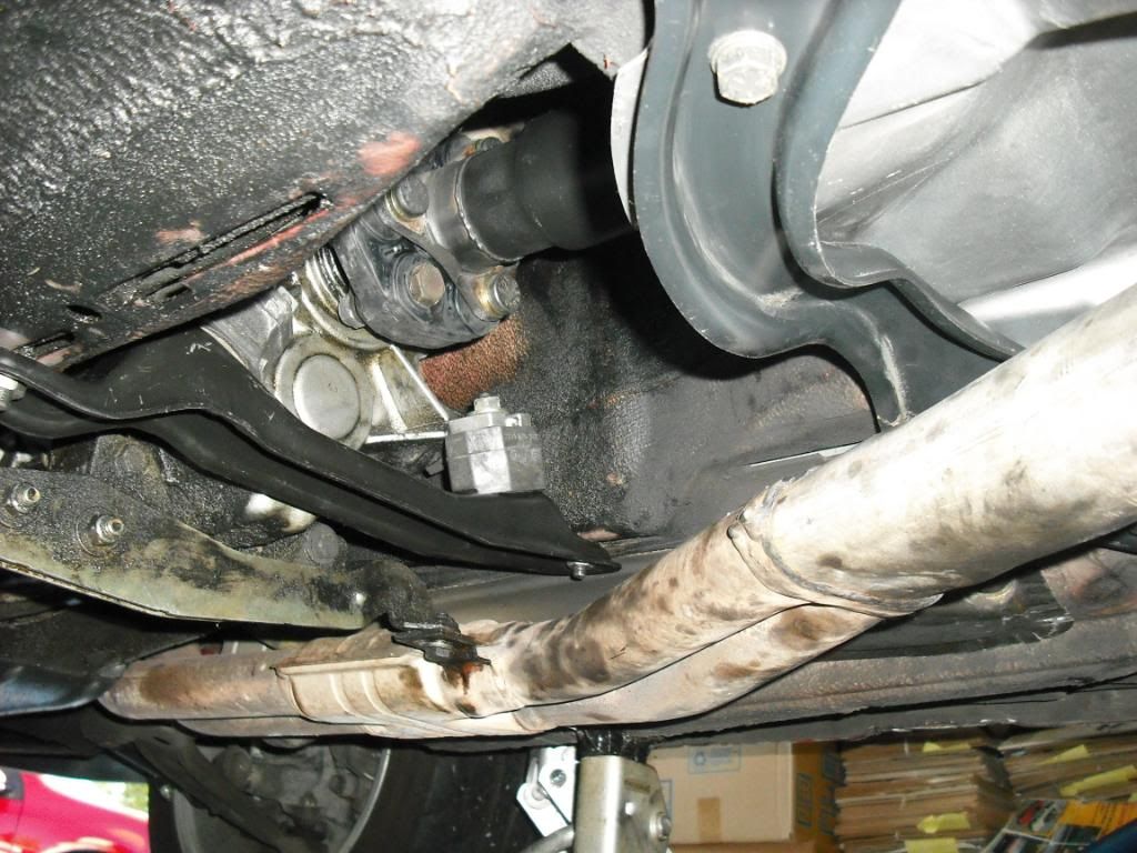

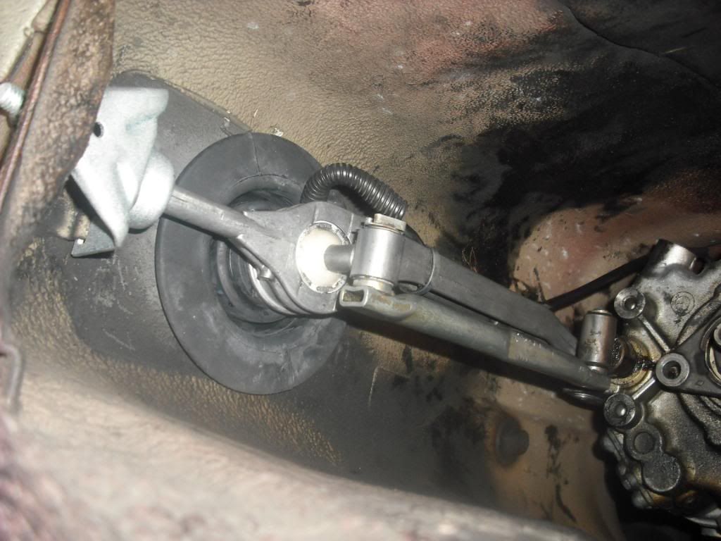

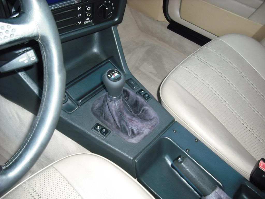

First off, brand new OEM Z3 1.9 shifter with 5-speed ZHP knob. Aslo installed all new shifter bushings, clips, lower boot, etc....
In STX, any mechanical shift linkage may be use, so the options are pretty wide open. I chose this set-up because it's a much cheaper alternative to the aftermarket set-ups such as UUC, yet still has a great feel & looks great. The knob is simply fantastic, one of the best I have ever felt in my hand!

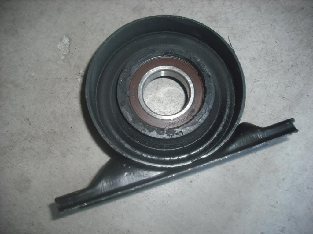

Next, since I had to remove everything to get to the shifter, new driveshaft center bearing, guibo/flex disc, & new transmission mounts...

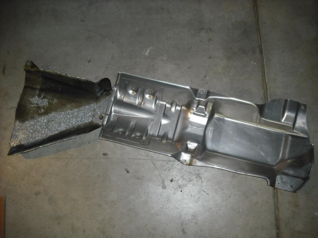

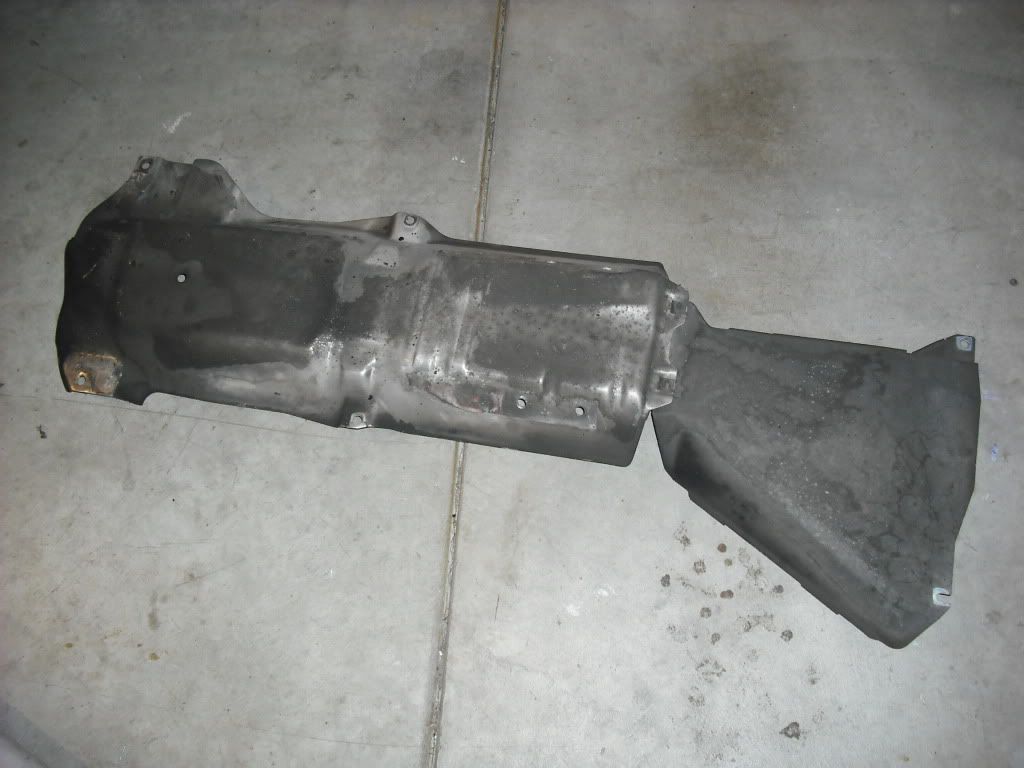

I also cleaned off the 23 years worth of grime off the exhaust shielding ;)
Some will say, "why not just remove the shielding?". Unfortunately, in STX we cannot remove any shielding or brackets unless it originally attached to the exhaust system. I figure I literally removed almost a pound of dirt & grime from it though...

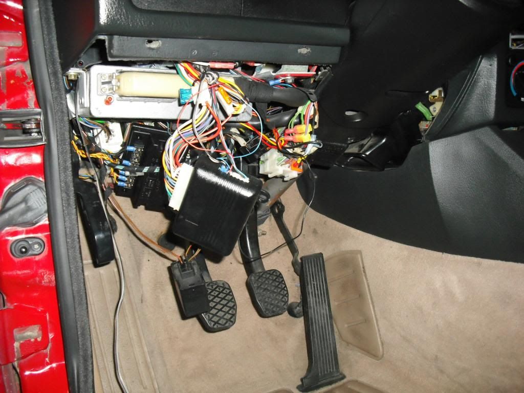

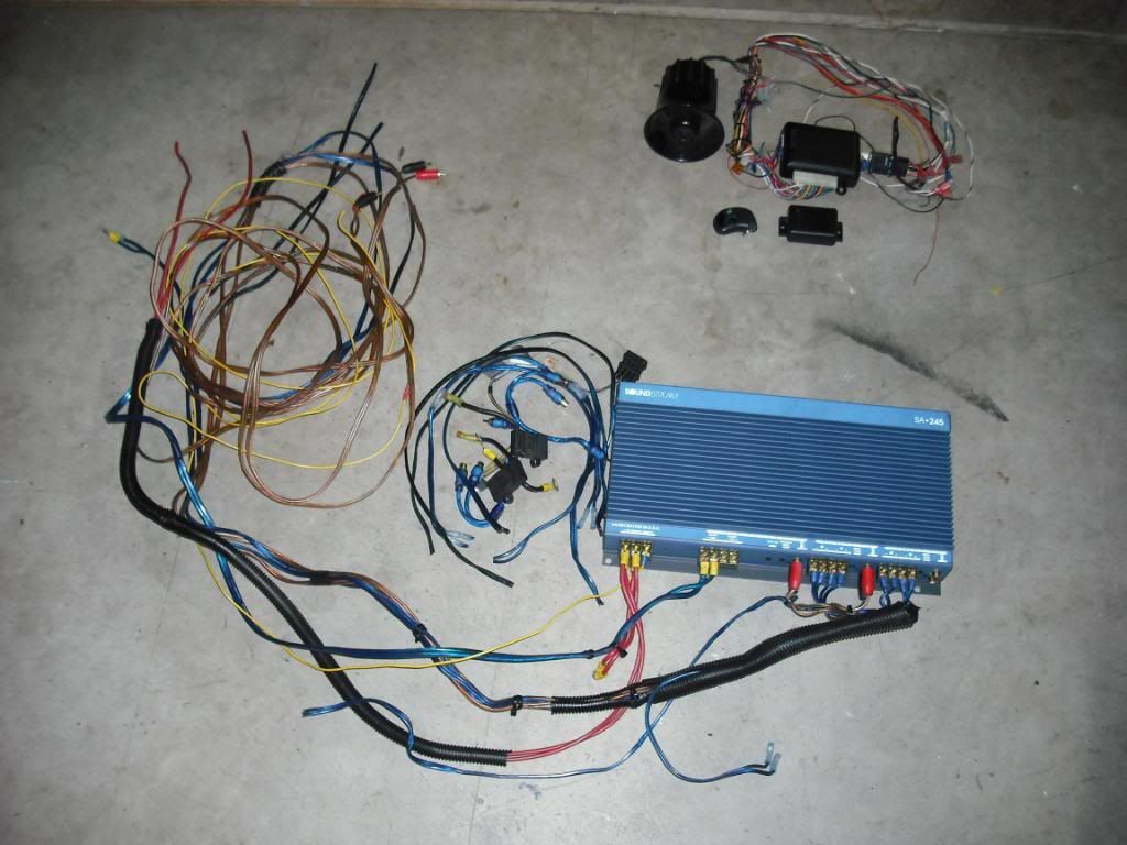

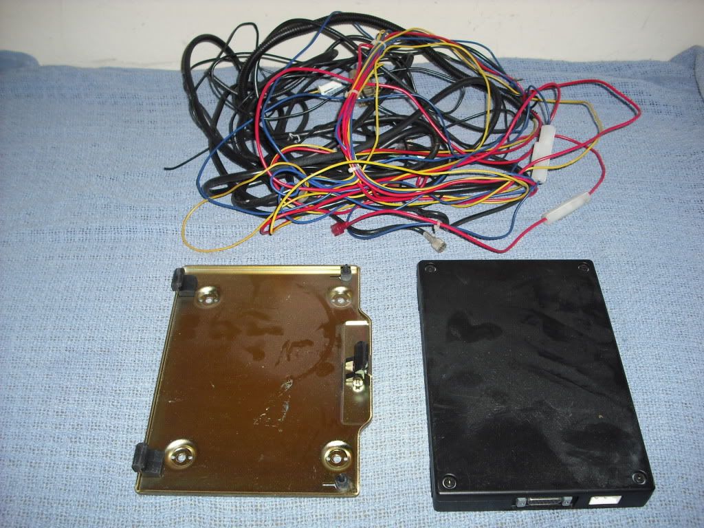

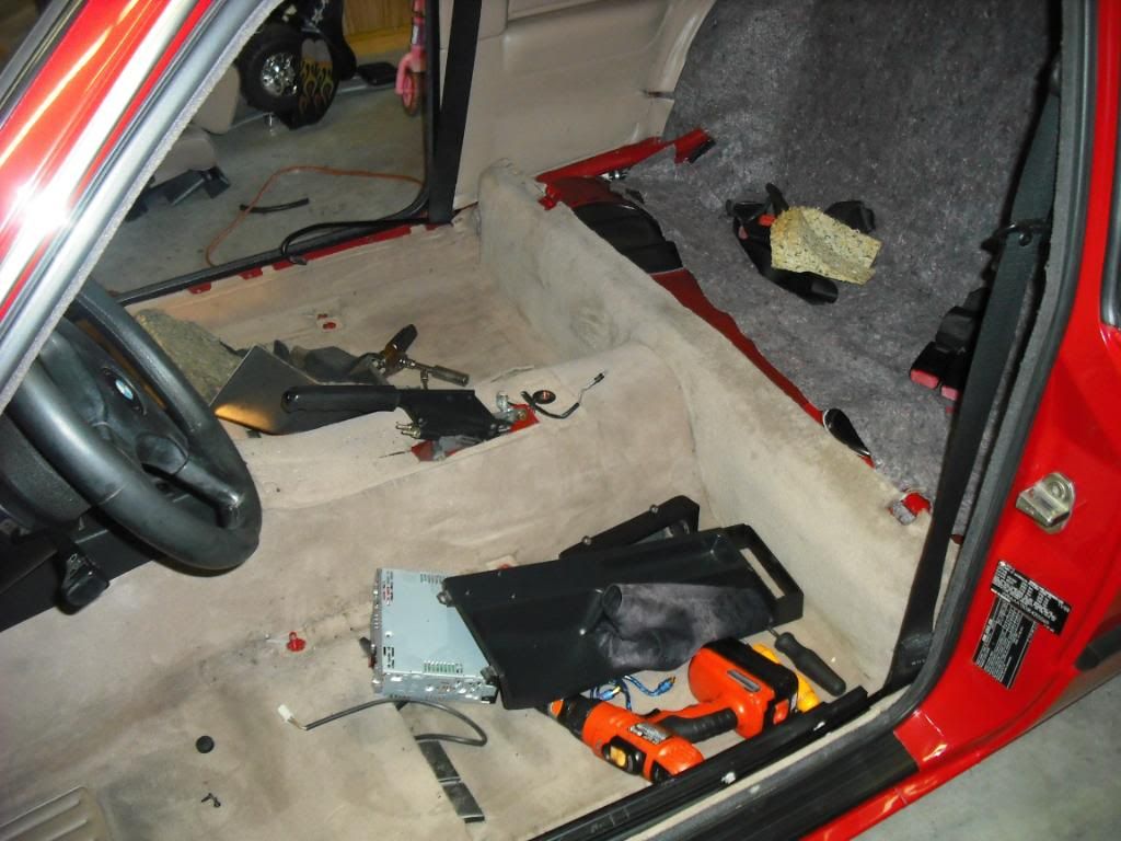

The last thing I did was remove the sound system & alarm that the previous owners had installed in the car, plus the original cell phone brain & wiring. This required a little more work than I had originally thought....
The wiring for the amplifier was run under directly under the carpet under the front seats, & the alarm system was a rat's nest of wiring under the dash...
After I was done, I ended up removing 19.5 lbs of electronics that doesn't need to be there for autocrossing ;)
In STX, if the car came with a stereo system standard, then it needs to retain one. However, head units & speakers may be changed as long as they do not materially reduce the weight of the car. In my case, the amplifier & all related wiring were not neccessary since the 325i did not have an amplified sound system stock, & the cell phone equipment was a dealer installed option, so again I can legally remove it. I do have to have a head-unit & at least 4 speakers, so I left my Sony CD player & MB Quart speakers in the car.

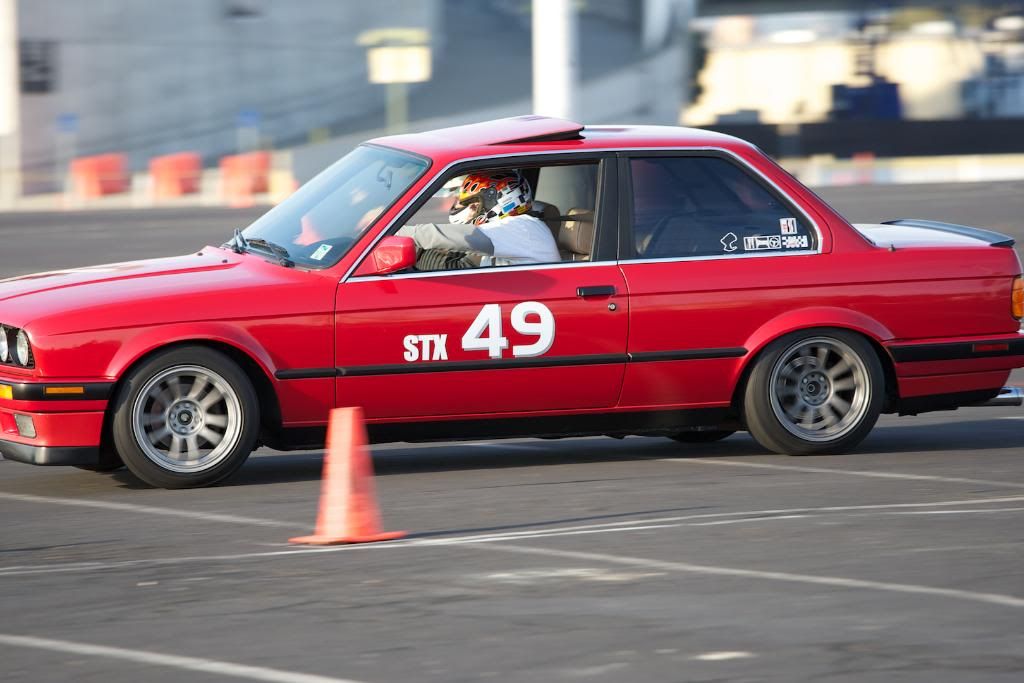

This past Sunday was Round 2 of the San Francisco Region SCCA winter "Slush" series. It was forcast to be a beautiful fall day, the E30 was up & running again after completing the previously mentioned work, so even though I know the car is nowhere near competitive in it's current state I decided "what the hell" - let's have some fun!
How did it do?? Well...not bad, but not great either, overall I have work to do ;)
There were 6 drivers in STX besides me...a late model Mustang GT, a WRX, 2 drivers in a very well prepped RX8, & 2 National-level drivers in a top-level ST Civic (keep in mind it is still 2011, therefore the Civic can still run STX). No surprise, the Civics were one-two, then one of the RX8 drivers, then me in 4th. I ended up about 2 tenths out of 3rd...or 1st non-Civic ;) However, the bigger news to me was that I was only a little more than a second off the leading Civic on a 48-second course. I know that's a lot of time, but considering how under-prepped the E30 is I now firmly believe it will compete! One of the great things about living hear in the SF Bay Area is that we have some of the fastest autocrossers in the country...if you can do well here, you can do well almost anywhere. So at least I feel I can get some meaningful information out of the results, the cars/drivers that finished ahead of me can finish well anywhere, so I was encouraged to be within striking distance.
So how did it drive? Well, as you would imagine, it's VERY soft! Vogtland springs & Bilstien Sports might feel great on the street, but they make the car painfully slow to respond & lean like crazy! This is nothing I didn't already know of course, a new (yet to be determined) suspension set-up will go in the car this winter. Positive notes are the power...the car pulled out of corners great, & the LSD diff I recently installed is working well. So well in fact I was battling power-on oversteer all day, which hurt my ability to get the power down coming off the corners...but I'll take that over inside wheel-spin or understeer any day!
What's next? First thing is to remove the aftermarket rear sway bar the car has installed. This should help plant the rear of the car on corner exit. Next will be to go through the brakes...although they weren't BAD, they were a little mushy & slow to respond at the limit. So, steel braided lines, DOT-4 fluid, & some agressive street/track pads that have good cold bite are on the menu. Those are the immediate plans before the next event, then in December (if work & family permit) it will be on to the bigger items, such as the suspension, exhaust, race seats, etc. :DMark Scroggs
