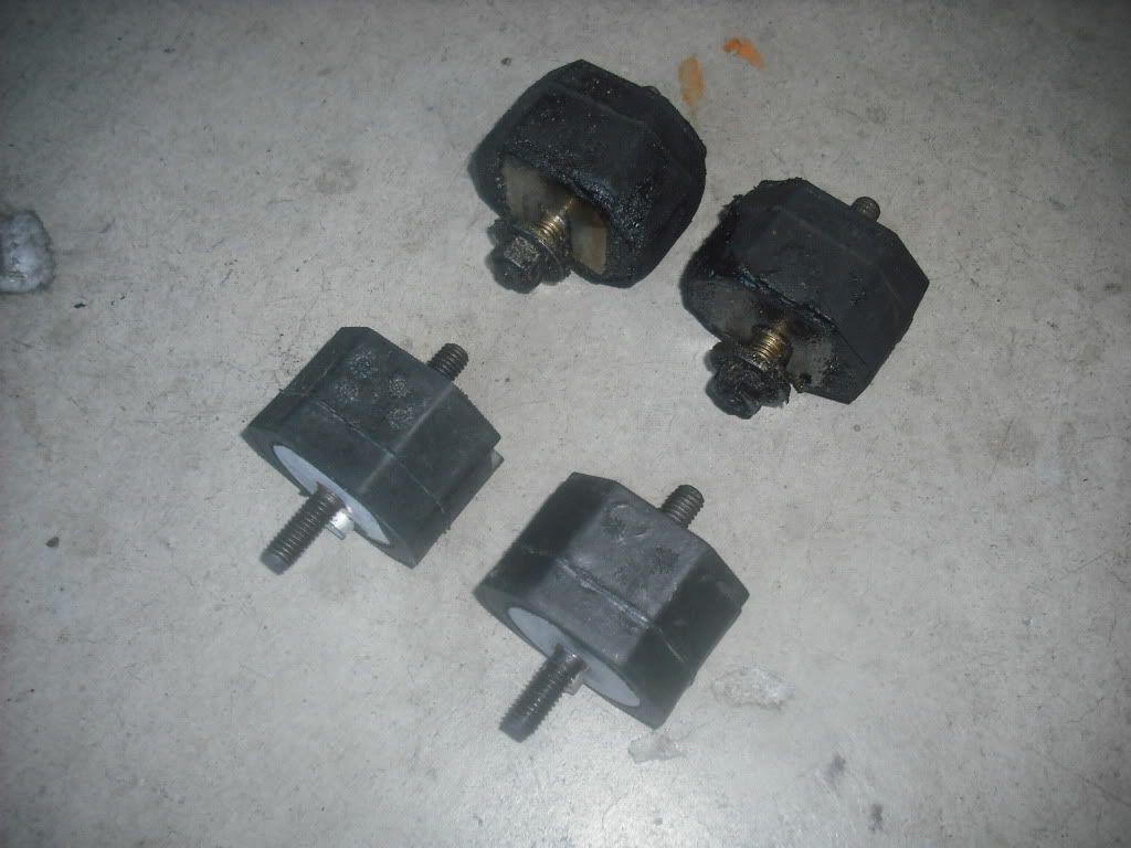

    Solid mounts on the transmission are not allowed in stx
    Dare 2 Dream Motorsports
      #62
      Correct...I did not install solid mounts, they are OEM rubber replacements ;) The lighting in that picture does make them appear metallic, here is a pic of them next to the old ones...
