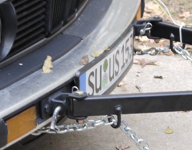

    Luckily, I am usually within range of the AAA Premium, so anything that renders the car non-rolling, I will use that avenue. I have rented both the UHaul dolly and the trailer. I saw no use for the extra weight of a dolly bouncing around back there, and the trailer with a car on top sways too much in the wind for my comfort. I set cruise control at 72mph flat towing and the Van seems to break the wind up. I also tow with the Rally tires to AutoX events, then swap out.

      Gary, did you weld the bar to the bumper brackets or bolt them on?

        Brackets are bolted on.

          Got any close up pics of that? I've got an old small bumper I might pull the mounting bits off of, wanna get an idea on something before I start dicking around.

            Is this what you need? Bracket fits into the bumper cover recess, has two grade 8 bolts that go right through the shock plates behind. Blue locktite, and they have never moved,

                    Anyone got pictures of a pulled apart late model plastic front bumper? Stuck at work and now I'm getting ideas..

                      take bumper off. adapter on the shocks.. or on the frame if you remove the 4-bolts on the shocks.
                      being a track car, i'm getting rid of them shocks. making my own (lighter) bumper mounts.. will keep this in mind if the transmission lubrication is not an issue (ZF e36 tranny in my case)
