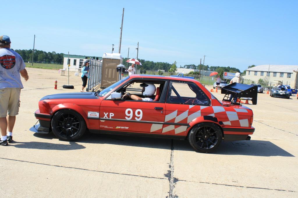

    the wheels are Rota grids, got them from wheeldude.com
    They are about 19lb each so they are on the heavier side.

      Are those DTM Fibrewerks flares?

        Yep
                Y'know, 19 lbs for a 17x9 is really not bad at all. It looks badass, it will be interesting to see what you think of the combo after an event. How was wheeldude to deal with? Were the wheels special order?
                      Wheels were special order, wheeldude was great and super helpful guys. Also a big plus is they are 15 minute drive from my office so no shipping needed.
