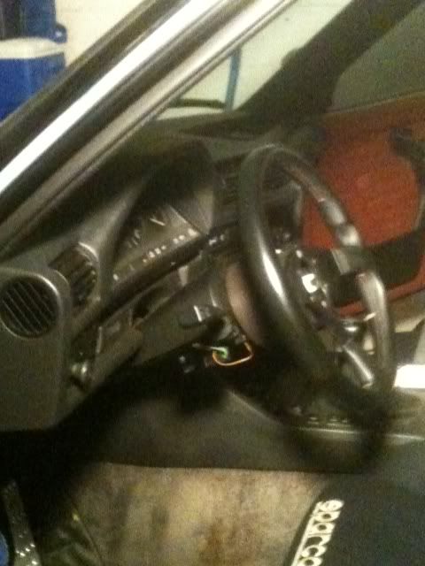

            I just spent 2 hours bent over backward underneath my dash. I couldn't get a good angle to cut the heads on the safety bolts with a dremel, so I went to a regular drill. My bits were all dull as shit, so this took most of the time. I ran to Lowes for some longer bolts and spacers (washers). I put it back together with about a 3/4" spacer.
            The wheel now sits in a much more comfortable position. The only drawback is that the top of the wheel now blocks the top of my gauges. Kind of a bummer, but worth that sacrifice. Overall, I'm quite happy with the results.

              shitty pic. the gap between the dash and column shows the change.
