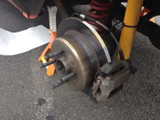

                          So I gathered some interesting data from my last race weekend. While there are still a lot of variables to be considered, the data told me that with my set up, the rear would benefit the most from some ducting.
                          My Setup
                          -Shaved RA1s
                          -Stock brake system(ABS removed)
                          -OP Parts front rotors, O'reilly rear rotors
                          -Porterfield R-4 pads
                          -Backing plates removed
                          -No ducting
                          -2650lbs ish
                          Track-Portland International Raceway
                          This race weekend I was on fresh rubber, much more grip than my previous tires! The first session was about heat cycling the tires, so I was light on everything. In that session the front rotors were under the first temperature reading of 800F, while the rear rotors were around 1000F.
                          Second session I beat on the brakes a little bit, but they still had no fade. Temperatures reached under 800F up front, but the rear had substantially more heat, almost reaching 1130F! That's starting to get up there in heat!
                          Picture of rear rotor after second session
                          Third session was qualifying, and I went out for some quick laps. For the first time I experienced a little pad fade going into the chicane, turn 1. This only happened when I went deep into the brake zone and was really hard on the brakes. I suspect the rear pads were the ones experiencing fade due to the heat indicated in the previous sessions. Back in the paddock and after inspecting the rotors, although they were much hotter, the swept surfaces looked perfect. Slight pad deposits, but a perfect burnish layer. Rotor temperatures were, Front 800-900F and Rear reached over 1130!
                          Picture of rear rotor after third session
                          During the race there was no difference in the data collected from the previous session, except again no brake fade was experienced.
                          Here's a little video showing the front suspension/brakes glowing red hot during qualifying
                          • nrubenstein
                            • 3148
                            #58
                            That is fantastic footage. I can't say that I'm surprised that heat issues move to the back in a car set up properly for racing. The stock rear rotors are terrible.

                                The stock set up is less than ideal. I am going to put some effort into the offseason to try and come up with a ducting system for the rear to try and reduce rotor temperatures to the more ideal 800-900F range.
                                Adjusting the bias may also play a little factor into this as well, since I have removed the ABS system but have not put a bias adjuster in. Brake performance seems to be more than adequate however, almost balanced perfectly. Thoughts?
