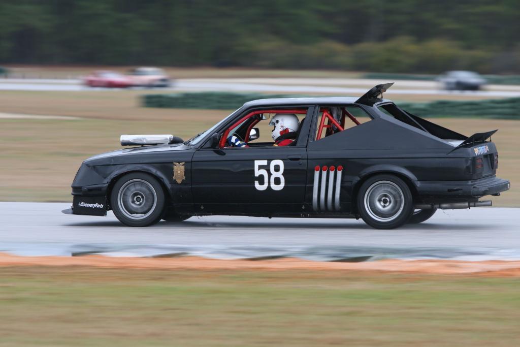

    Need some input. Our 86 e30 race car ( M30 conversion) gets very loose during left hand turns. The car oversteers without much help with the throttle. Right hand turn are awesome - the car sticks and goes - no issues. We race at CMP / VIR and all 5 drivers experience the same issue so it isn't just my driving style.
    It has IE Stage 3 springs, Sport shocks/struts, full Mad Max aero kit , 3.73lsd , with many alignment jobs. Factory rear sway and Convert front sway. We run the fronts at -3 degrees and I think the rears are around -2 degrees (we don't have camber kit on the a-arms).
    Any ideas why the left turns would get loose vs right hand??
    Getting ready to put a 4.10 LSD in for the next race - so the torque in the corners will be crazy. Would having 40% lockup help vs. factory??
    Thanks
