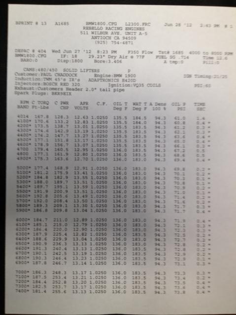

        I'll attach a dyno sheet from ours, its just a random run, made 255 this run, IIRC, best run was 266hp, 198tq.
        I have a lot of the runs on video.
        Paul

          Originally posted by pmachan
          Wet sump yes.
          Yeah, when we were shopping the build around, Dave showed me some other M42's he had done, very impressive.
          Killer!! It makes power all the way to 7.5 limit and im guessing a bit beyond; what rpm are the cams set to drop off at?
          .... really tempting to have done for a gts2; reverse swap from m3 6 cyl to 4cyl like the Supra mk4 in JGTC
          Sent from my GT-N7100 using Tapatalk 2
            Not sure how competitive the light car/small motor thing is in NASA GTS. If you can start out front and keep the higher power cars behind initially until you get through a few corners, great, if not, its a hard go.
            The power cars out drag you, then park in the corner, VERY hard to pass, especially if they make it difficult.
            Hot setup in GTS3 I believe is an e36 m3 with an S54, detuned, the TQ characteristics are very good vs a built s52.
            I have no idea if our car was competitive in GTS2 with the old MM motor.
            The cams peak around 7400-7500, start dropping after that the way its tuned currently, red shift lights go off at 7600 I think, with rev limit at 7800.

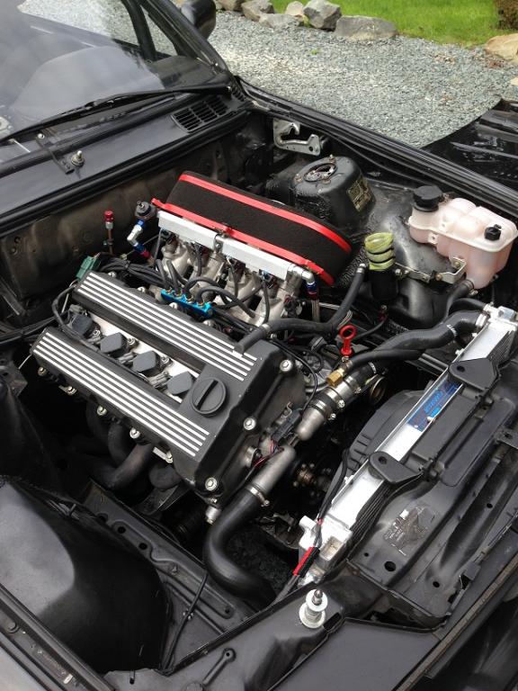

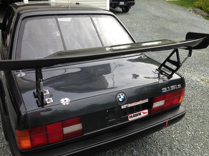

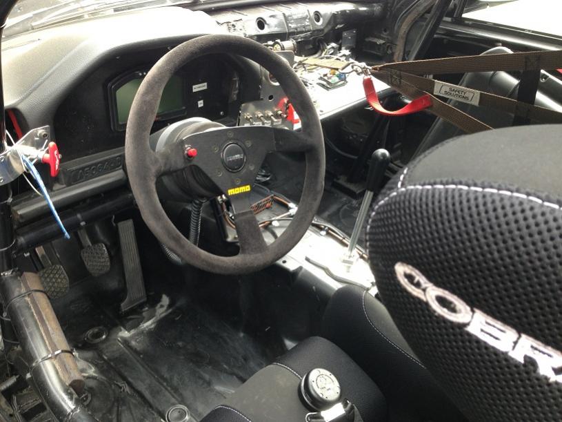

                  I took a few updated pics of the car today, showing some more detail.
                  Will include a vid from our last race as well (2 weeks ago).
                  Paul

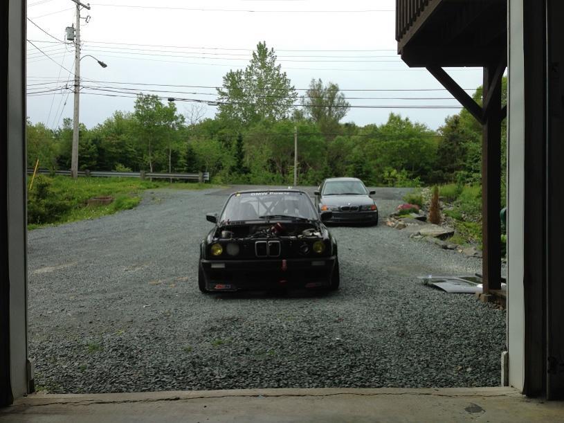

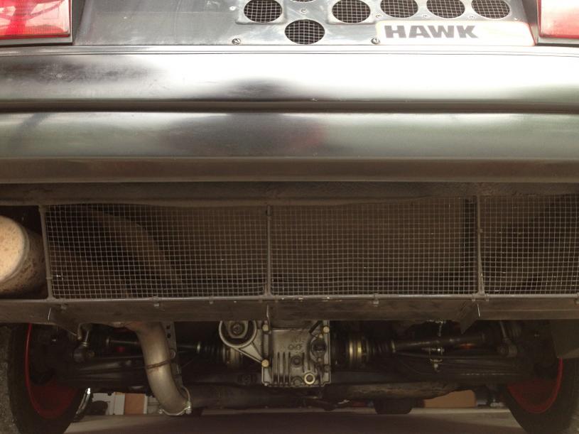

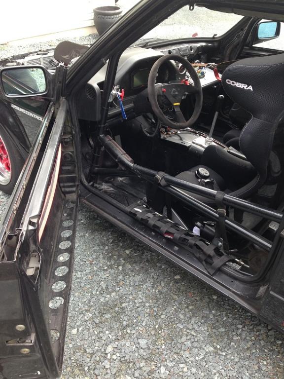

                    #39
                    More
                    Paul
                    91 318is GT3
                    08 328xi wagon

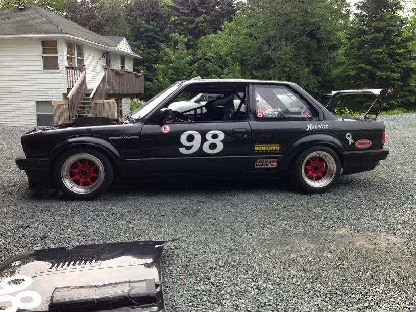

                      #40
                      Paul
