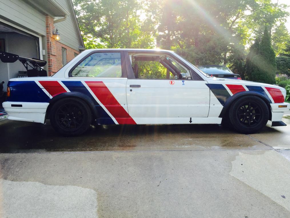

            No updates yet, its still in the trailer. I honestly think its going to be fixable, I took a quick look around inside last night, cage did not move at all, so repair would just be cosmetic as far as I know right now. May change when I get it in the air and have a good look. I'll post pics and updates as I go forward.

                See what you find when you get the fender off-
                if it hasn't moved the strut attachment much, it might be pullable.
                You can always section that quarter of it, but it's always a trade- off on how much work to
                do that versus a new shell. And how hard it is to do the re- attachement welding.
                Glad you're ok- that's a scary place to contact something...
