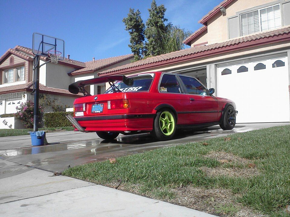

    so ive decided to make the change from drifting to time attack. i really over trying to compete in pro am events that have no chance in at all with all these big money teams. heres my drift setup
    chassis: 84 318i, bd racing (drift) 6 point with door bars
    engine: m20b25, straight pipe exhaust, intake, and i think my ecu is chipped(153)
    brakes: stock 318i front, 325i rear disc brake conversion
    suspension: bilstein sports shocks, ground control sleeves, cosmos camber plates, ge top hats, ebiach 500lbs springs up front, ie3 rears springs in the back, m3 cabs, ie subframe and trailing arm bushings, ie posi locks, front vert bar, no rear bar
    diff: 4.10 welded
    wheel and tire: 16in wheels with 205 55 16 tires
    aerodynamics: adjustable gt wing
    so my question to the grip guys is what should i change up? heres what im thinking, 325 front brakes with track pads, add a rear bar im thinking maybe an ix bar(i know where to get one for a good price) 4.10lsd(is the ix diff rear diff a bad idea for the track?) 15in. wheels with either 205 or 225 50 15 tires, some more engine performance.
    help me out guys

            sorry dude, IMHO if you are serious about time attack and want to be competitive I would suggest choosing a more competitive platform than the E30 chassis. At least step up to E36 chassis. The amount of money you'll have to dump into your car to be as fast as an S2000 will make you feel bad!
            Just do it for fun and set those personal records (and chase those miatas) =]
            Also, I'd like to see some pics of your aero setup. PM me!

              dat splitter =]

                im going to stick with the chassis i have for right now since it kinda semi built already:p i just have an adjustable wing for the trunk, nothing serious, i had a front splitter on the front for quite some time but then i broke it at the track, i need to make another one.
