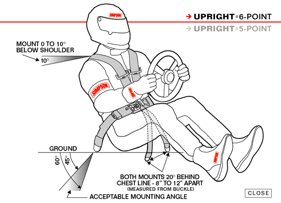

    I have Massive sidemounts that use the stock front studs and rear bolts to secure a race seat to the floor.
    My question is, how and where do I secure the sub straps and lap belts? For the lap belts, can I use the rear bolt holes and thread eyelets into those bolt holes instead of bolts? And do I drill the floor for a couple eyelets/eyelet plates underneath the seat for the anti-sub straps?

        All anchoring points shall be thru the floor. That's wha FIA and US racing organisations require. And don't forget thick washers behind the sheetmetal.
        The outer lapbelt mounting point could be done with an eyelet bolted to the threaded hole where the original belt's slider bolted.
        The inner lapbelt mounting point could be done thru the tranny tunnel. Don't forget a washer.
        Both crotchbelt mounting point should be at the vertical of the seat's slot between your legs, or no more than one each rearward.

                  I suggest to use eyelets (#700050/60) on the floor for crotchbelts and lapbelts, and snaphooks (#700030) at the ends of crotchbelts and lapbelts. Be carefull with the angle of the shoulder belts. 0° (horizontal) down to 10/15° maximum. Lower than that and your risk spinal compression under impact.
