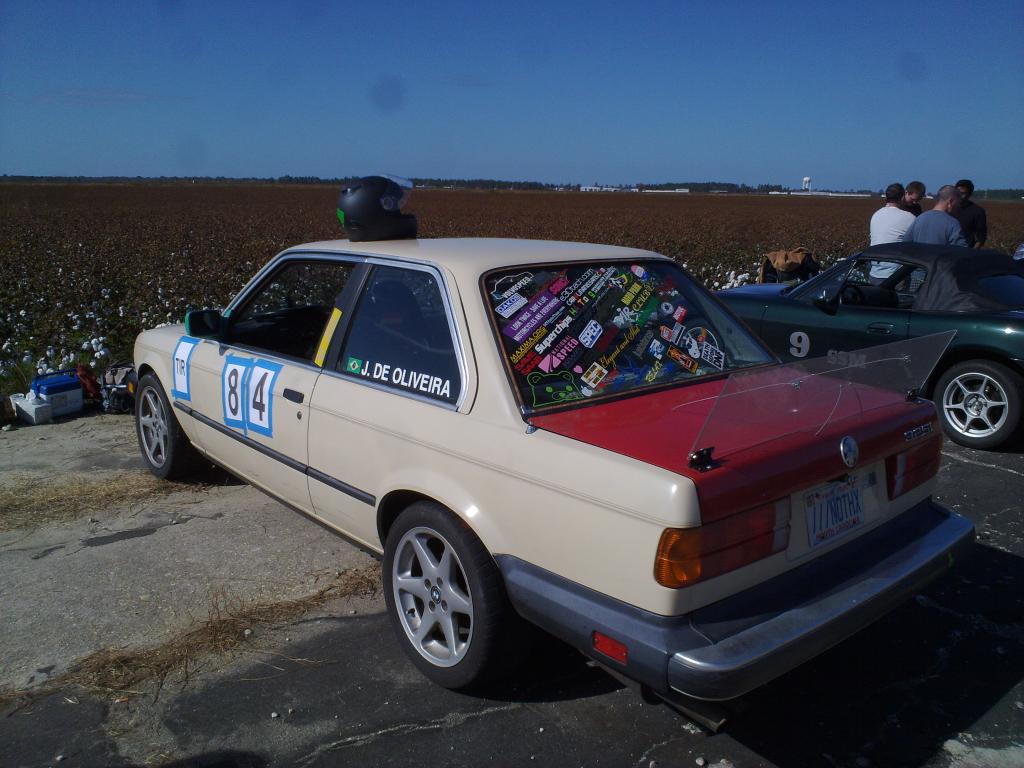

                          I attached my spoiler that I used for autocross. It's ugly but it matches regulations. 10" tall and only starting to be effective at the top of 2nd gear(61mph). It was barely noticeable, even in the wet.
                          '84 318i M10B18 147- Safari Beige
                          NA: 93whp/90ftlbs, MS2E w/ LC, 2-Step
                          Turbo: 221whp/214ftlbs, MS3x flex @ 17psi
