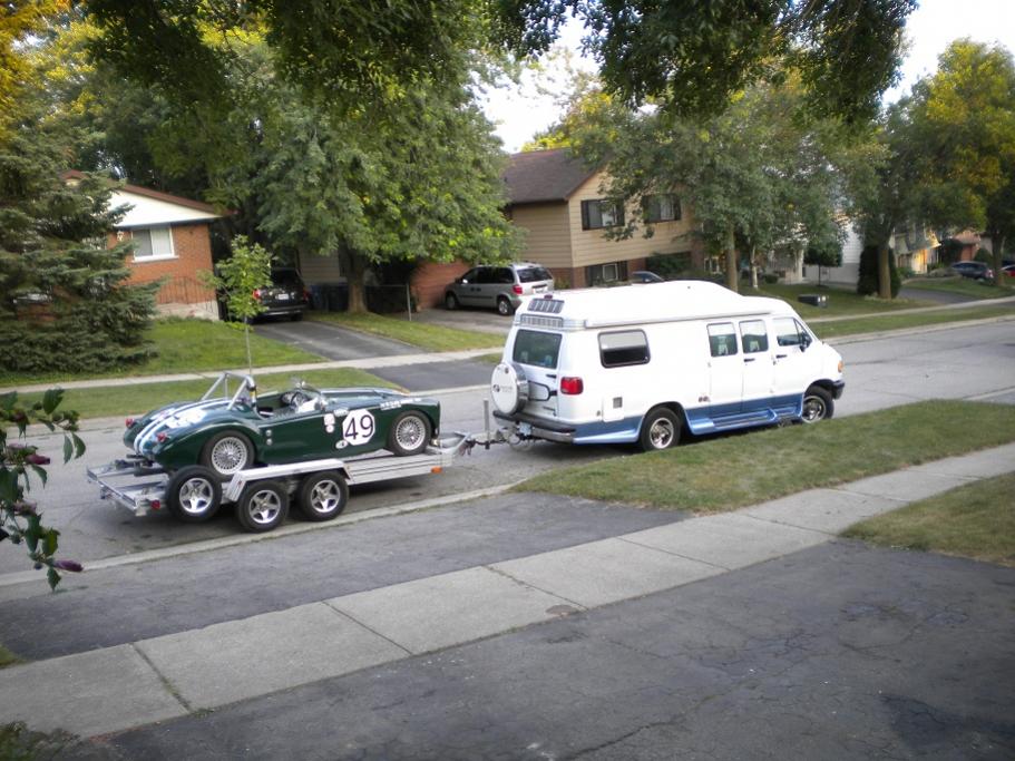

Interesting thread you've started here ... I started vintage racing a '56 MGA last year and have had many of the same transportation issues that you've noted, and the thought of converting a straight truck into a car hauler crossed my mind. I passed on the idea due to the expense. Some things to consider ...
Don't buy a used U-Haul regardless of the price. Even the new rigs on the road are used up POS's. I've read studies where consumer magazines have randomly rented u-hauls across Canada - over 80% of the trucks they looked at (that could be rented) wouldn't pass a safety. Stay away from them.

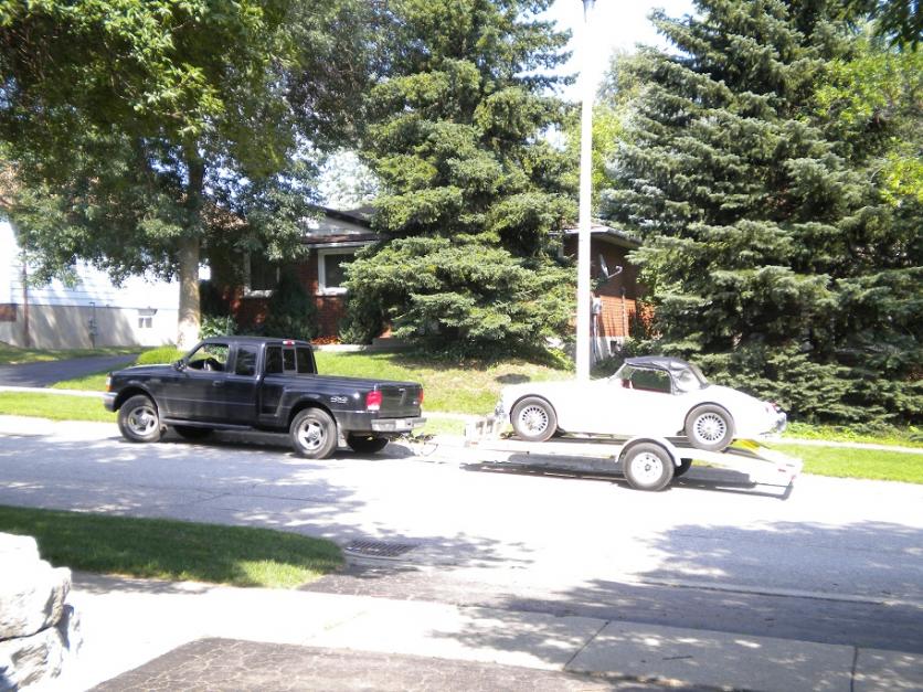

What size Ranger do you have? I use a 2000 Ranger 4x4 with the 4.0 V6. It's rated at 5000 lbs towing capacity. It was my father's. He bought it new. He passed away 5 years ago, so my mom keeps it at her place and I / my brothers use it whenever we need a truck. I've towed all over with it (probably 30,000+ km) without issues. I think the key is getting the right trailer - the lighter the better, less strain on the truck, better MPG's. I first had a single axle, aluminum trailer, but have since upgraded to a duel axle Trailex, bought used.

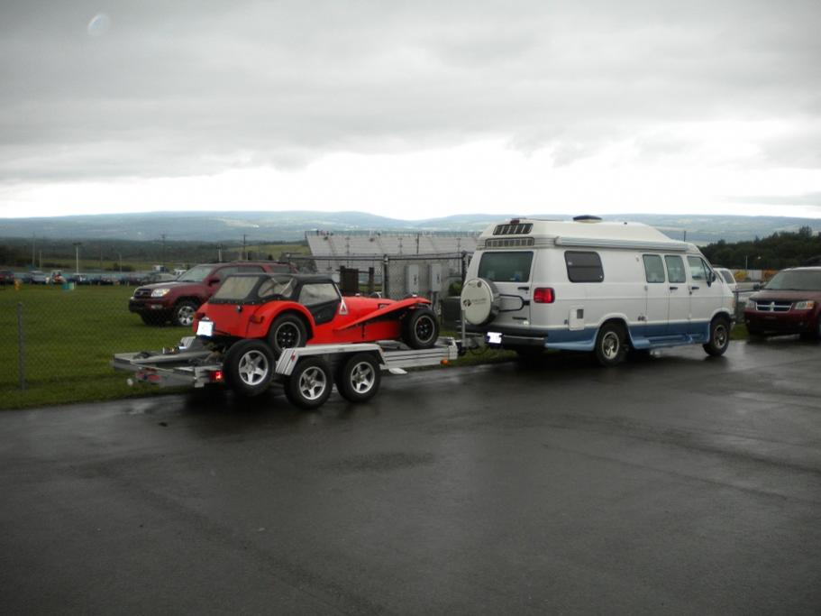

The trailex is one of the best aluminum trailers around. It's 845lbs empty, brakes on both axles and very long ramps for low cars. I have a tire rack, but took it off. They are expensive, even used, but are considered lifetime trailers. The trailex with an e30 would weigh in at about 3700lbs +/-
Also, have you considered a conversion van? Last year, I experimented with a Roadtrek. Rated at 7500lbs towing capacity,(probably a little optimistic) has all the comforts of home (fridge, stove, micro, AC, shower, sh1tter, ect) It worked very well for for a weekend at the track. I sold it off at the end of last season and am currently looking for a class C (more room, more pulling power, but more fuel consumption).Last edited by lgb240; 07-31-2014, 05:38 PM.lgb240
