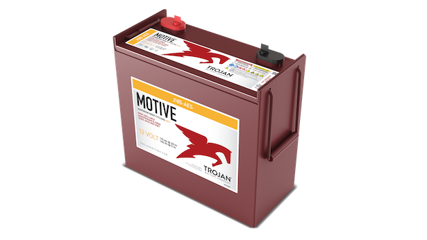

                          and four of these batteries:
                          The J185-AES 12V battery offers excellent energy output for applications including floor cleaning machines, with up to 3x the cycle life of standard AGM batteries.
                          if i'm doing my math right, i should be able to run a microwave for a few hours with just one of these batteries (not that i'd be doing that). with four i should be damn solid for what i plan on using them for. max amount of waking hours i'll spend in the bus is maybe 4-5 per day (when i'm not traveling that is). unless i run into 4-5 days of constant rain/clouds, i don't think i'll ever need a generator.
