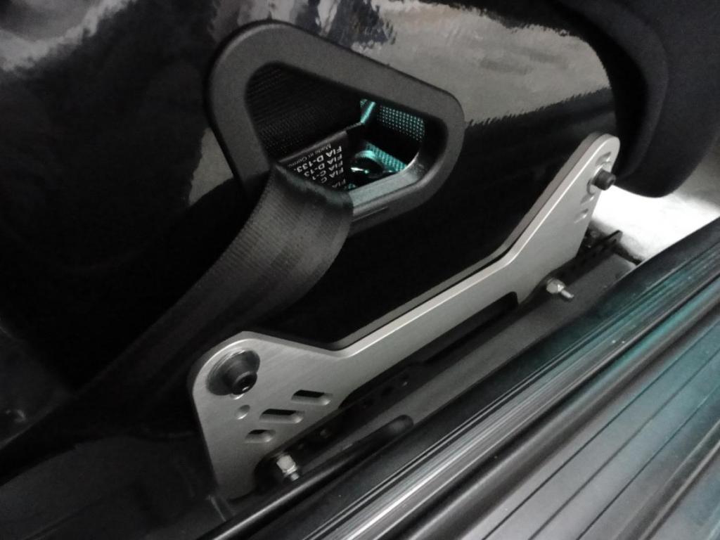

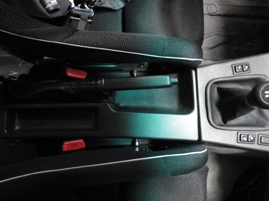

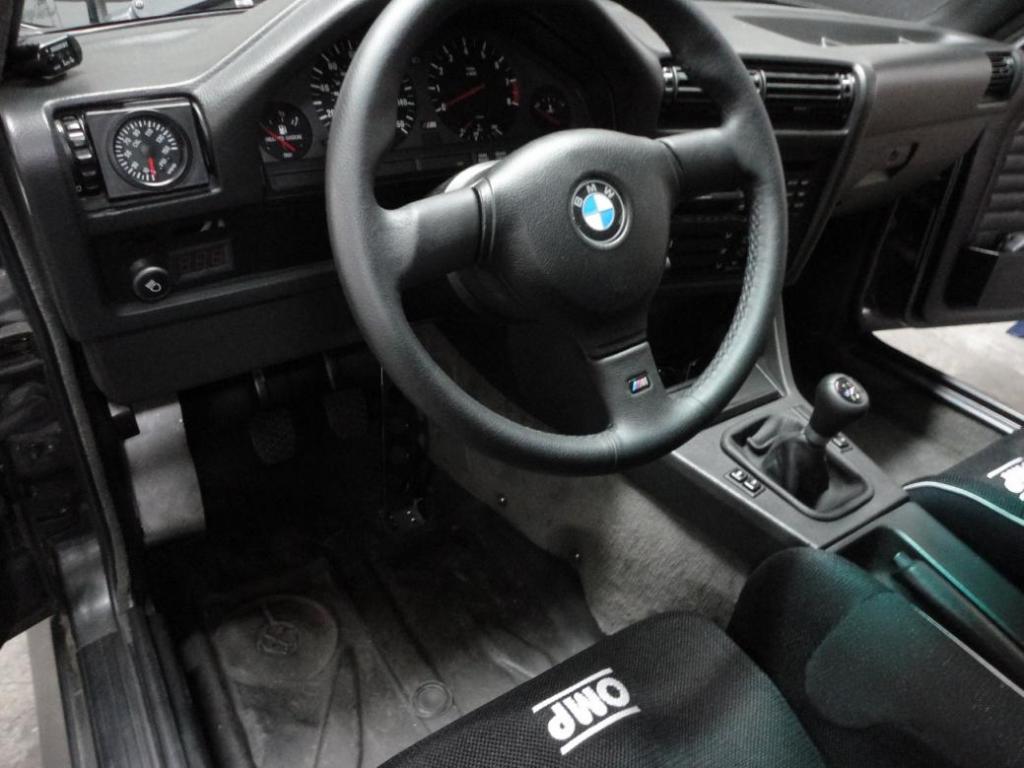

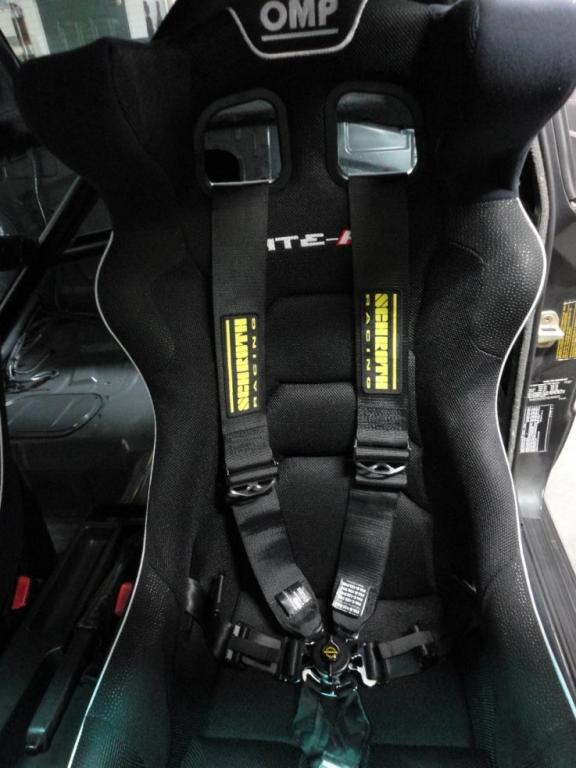

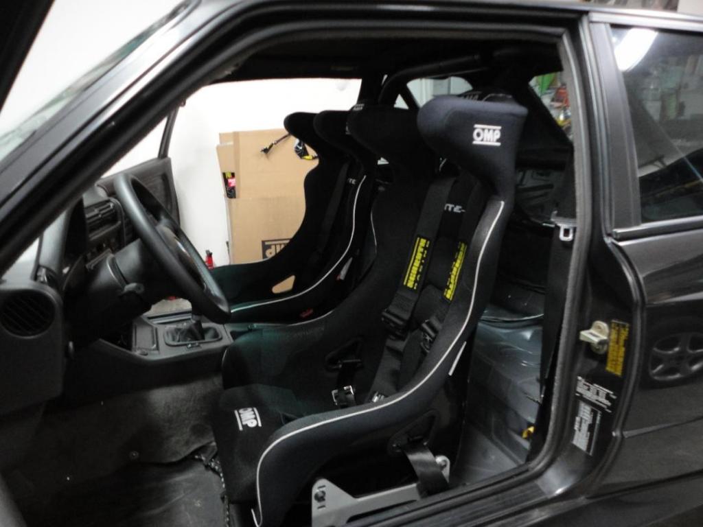

                  When it comes to E30 seat mounts Lee at Massive Brakes has the best out there. Flip the brackets and mock up several times and you can get the seats centered to the steering wheel. Closer to the center tunnel than any other mount, and lower than most probably ever want to go. A 1/4" left or right makes a big ergonomic difference on fixed seating position.
                  I'm 6' 1" and have no problem getting comfortable in the new XL HTE-Rs.
                  Edited; tried uploading attachments this time.
                    Your photo links aren't working. Is this the part you're referring to?
                    I forgot Lee had that mount. I emailed him, and using the setup link above, they are 78mm (3") to the lowest hole. That may work!

                            • autox320
                              • Sep 2013
                              • 31
                              Attached images instead.
                              Happy racing.
