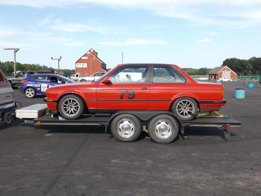

                • Eric
                  • 5142
                  Do you have pics of your trailer Toby? I've been thinking a small single axle will work fine for an E30, you see it in europe all the time.
                  We go big with our pickup trucks in 'Merica... same with our trailers!
                  • TobyB
                    • Oct 2011
                    • 5298
                    when I was building it...
                    a few years later, right about as I was learning about differential shock rebound rates...
                    The trick is to get a heavy, drop- spindle axle and then run trailer brakes. I've towed all sorts of shit
                    all over the state (and up to Canada) with it, and it behaves very well behind a small tow vehicle
                    (note Montero in background- yep, that worked)
                    t
                    • Eric
                      • 5142
                      Toby, trailer looks great, but why are you trying to make your 2002 look like an alpha gtv?

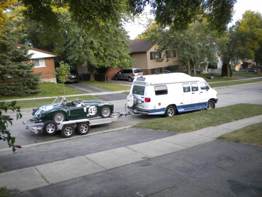

                            • lgb240
                              • 204
                              For open trailers, get a Trailex. 845lbs empty, can tow with a smallish tow vehicle. It's expensive, but, consider it a lifetime trailer. Look for a used one. If / when you want to sell, people will be lined up to buy it, usually at more than what you've paid for it. See mine attached. I've towed my e46xi touring and e30 touring with it. My tow vehicle is usually a Ford ranger 4x4 with a 4.0v6 - no issues at all.
