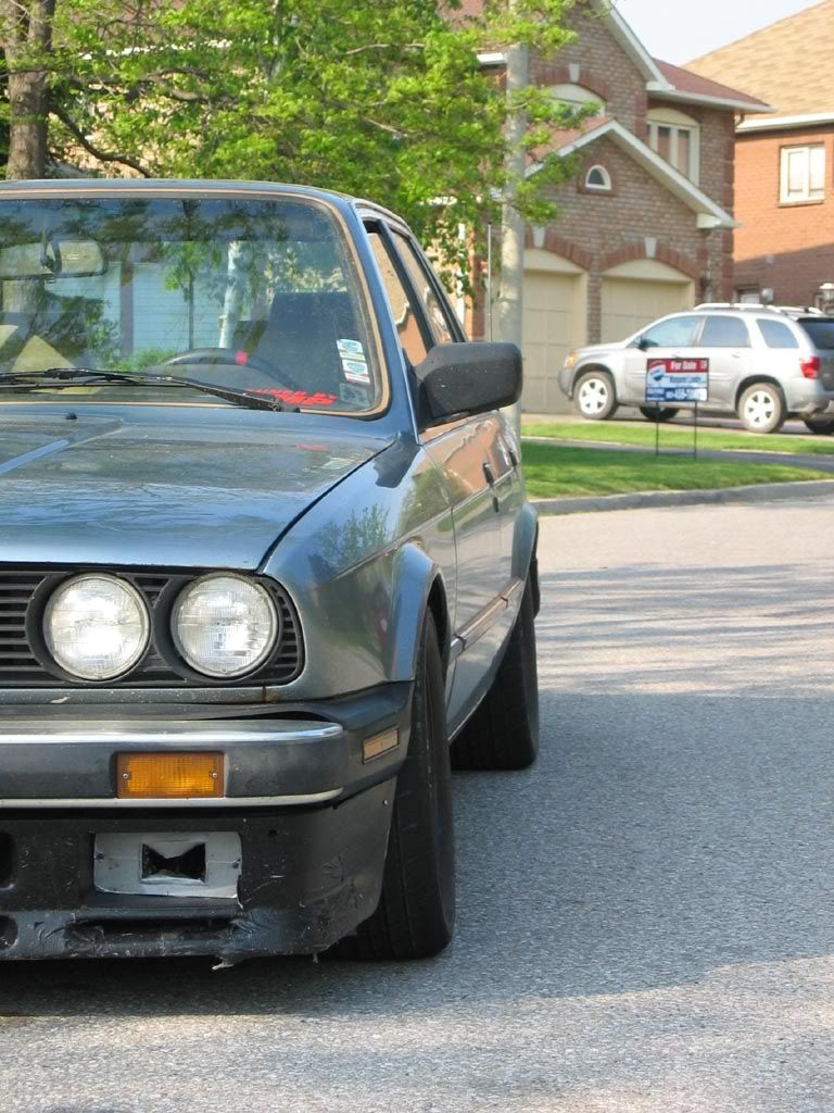

                          • nando
                            • 34844
                            here's my car with the hoosiers mounted on one side, it's very close but they fit nicely:
                            you can't see it very well, but I had to cut part of the rear flares away and I rolled the rear lips with a sledgehammer, it's *barely* enough for the tires to clear under full suspension compression. honestly I can't beleive how well they fit, it's almost as if the 14" weaves, hoosiers and the ix were meant to be. the offset is just about perfect, and I needed to do the fender clearancing in the back anyway because my euro weaves rubbed pretty badly with the BFGs mounted.
                            I also put boards under the tires because I didn't want gravel to stick into them, but it ended up not mattering because the autox right after this was very gravely - I actually melted some rocks into the r/f tire. oh well, I guess that's what they are for :D
                            Build thread
