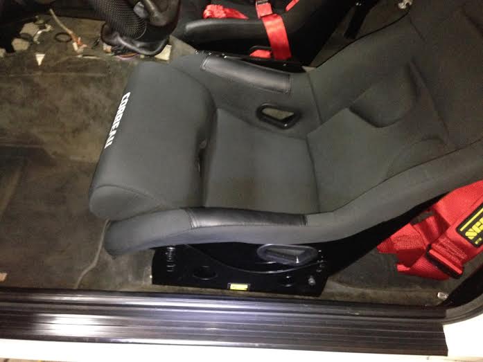

                    We're trying to use OMP's low side mounts - great deal @ $69. I'll post up how it turns out. We want the seat as low as possible to clear the roll cage with tall drivers, so no slider in the stack.

                            Update: If it fits, I sits.
                            Works, it is tight but $69-75 beats $290 for the VAC Motorsports one if you're doing LeMons. (Note, installed in a teammate's non-LeMony car)
