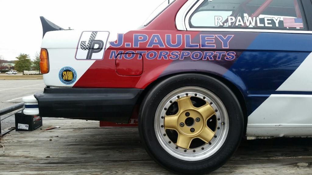

                            225/45/16s wrapped in Hoosier R6s...in my experience as much wheel/tire that a stock E30 body/fenders can handle. I would like to know if anyone here has flared the stock fenders rather than cutting and going over-fenders?

                              In more relevant information, I ran square 235/40/17 NT01's on Apex ARC-8's with just a roll in the rear and had no issues. That said, I'm pretty sure anything that is or runs wider would require more fender work to fit.
