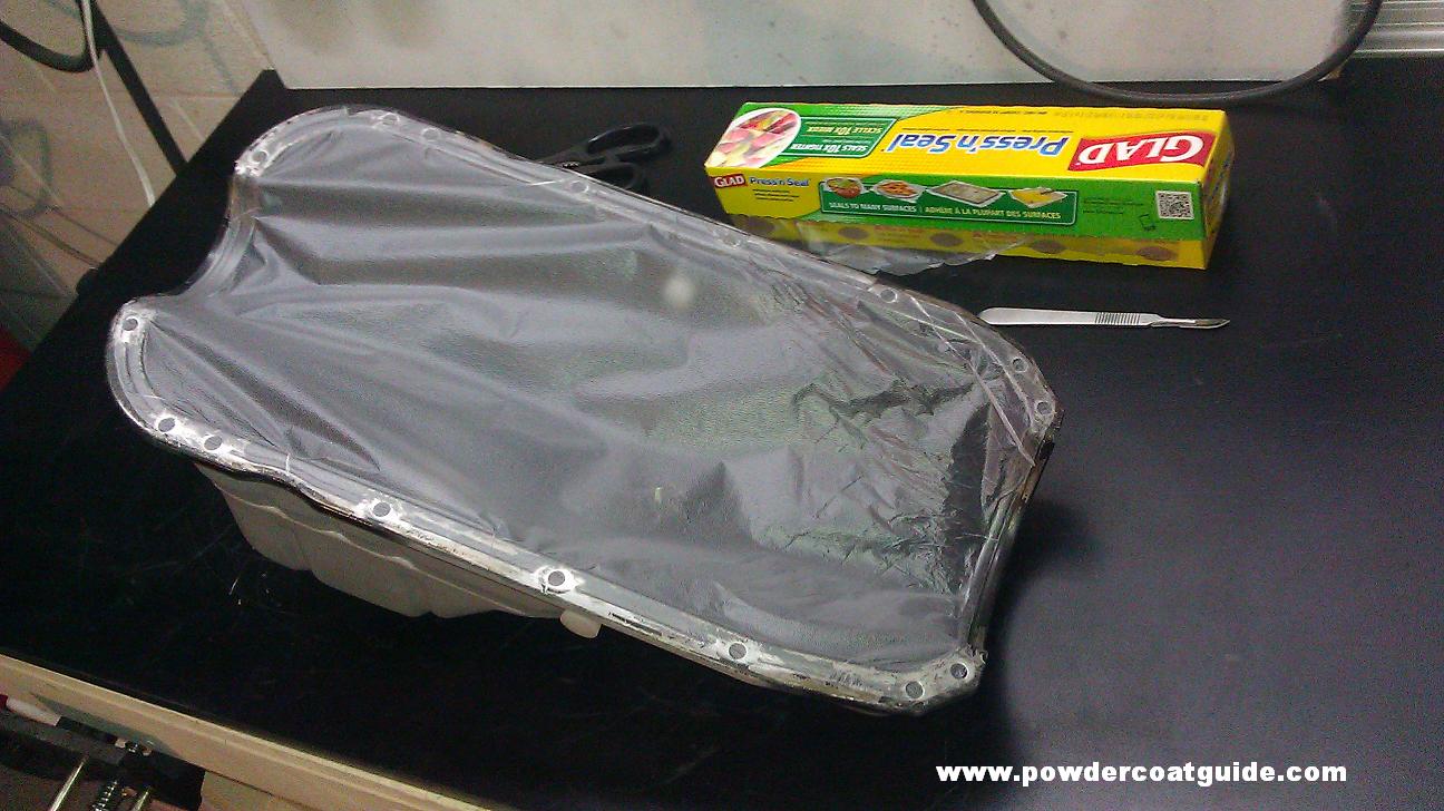

    Usually the bottom of the valve cover is not powdecoated it would just be covered and masked before the process begins.
