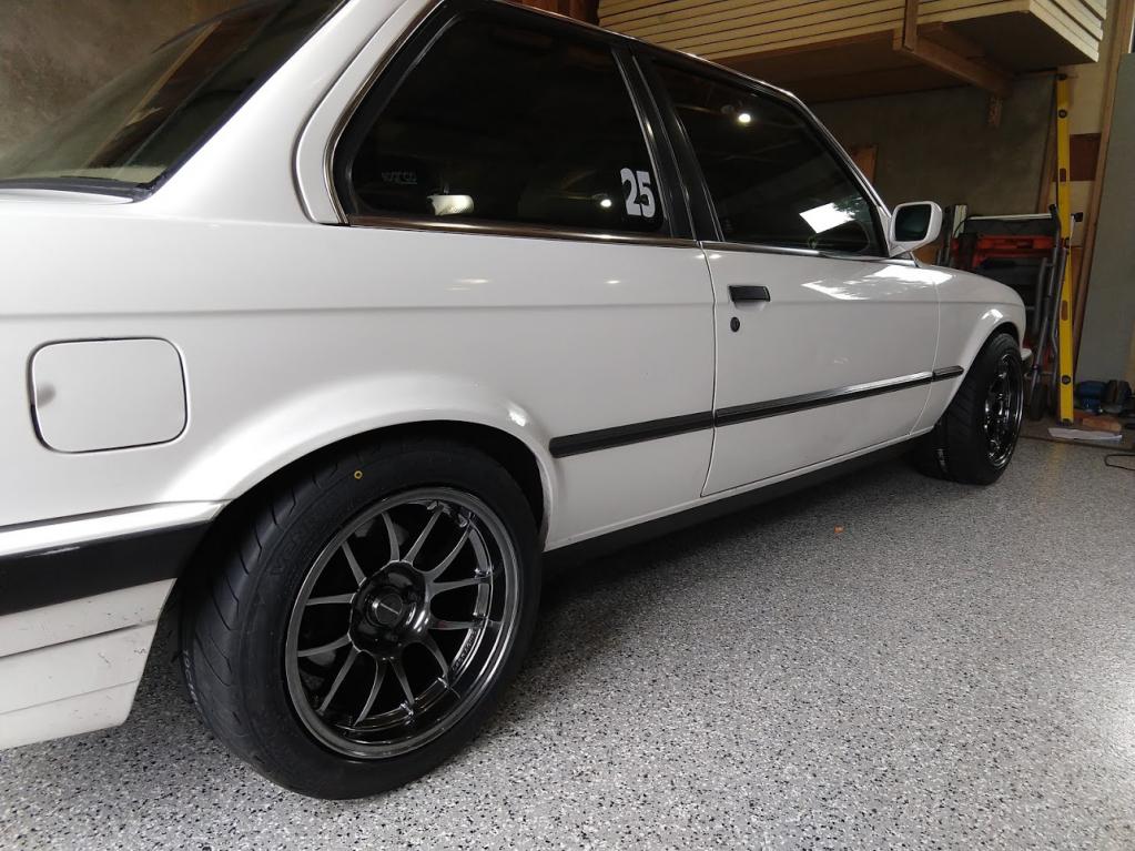

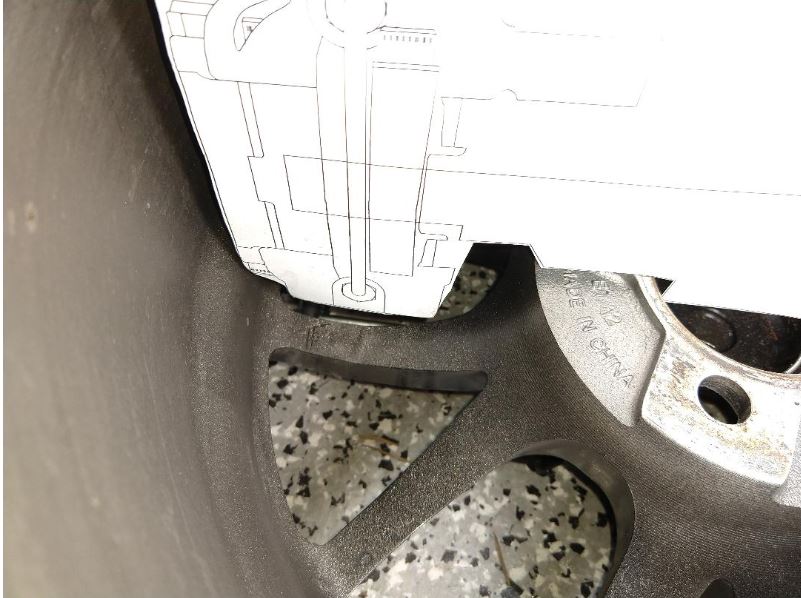

      This is 15x9 et12 6UL wheels, Tungsten finish, with 225/45 Hankook RS4.
      3mm spacers in the front give me 4mm of strut clearance.
      GC coilovers.
      Slight rubbing in the right-rear, which is weird because this car had 245s on 5 lug a few years ago and the fenders were rolled to fit. Resolved with a baseball bat adjustment of the inner fender lip.
      Weight of the tire+wheel is 33.8lbs, exactly the same as before with the smaller 215's on 8 inch TRM C1's.
      Tires seem fine so far.

          These will clear 300x22 BBK easily and probably the 300x32 as well.
