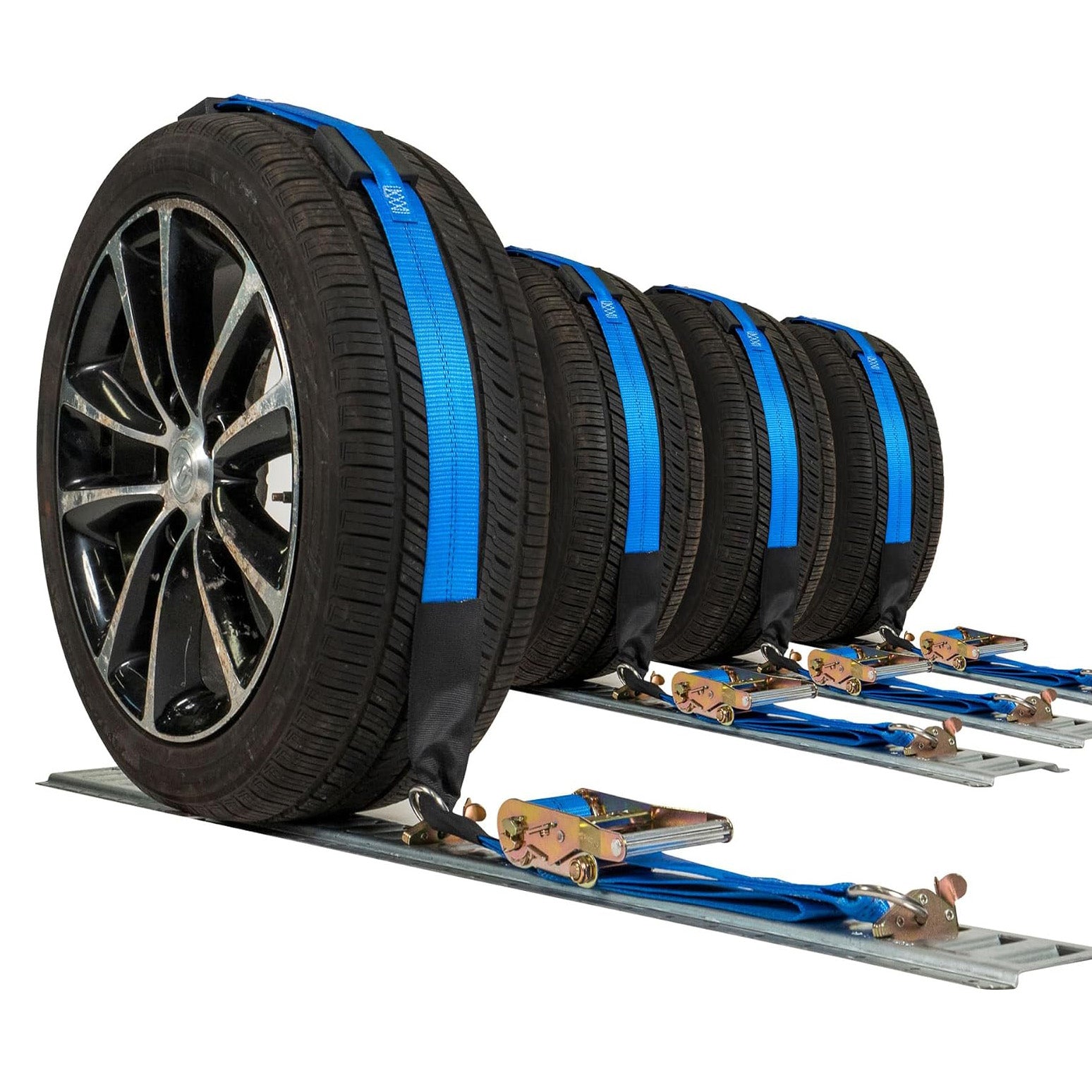

                            These tie downs work nice
                            I mounted E-track to the deck of the trailer and am using these straps:
                            4-Pack Wheel Straps with E-Track Fittings & 3 Rubber Blocks is perfect for low-clearance E-Track applications. Shop more options at US Cargo Control!
                            They work pretty well. Jeff
