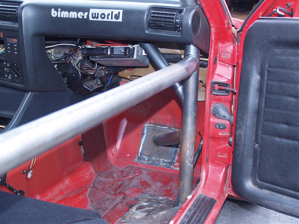

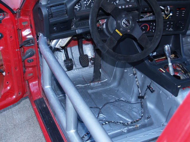

      Matt,
      Here is better!
      Done by a good ole NC boy.
      Note the A pillar bar is way up in the dash and yes a dash bar up in there too!
      Do these NASCAR bars look weak or bad to anyone?

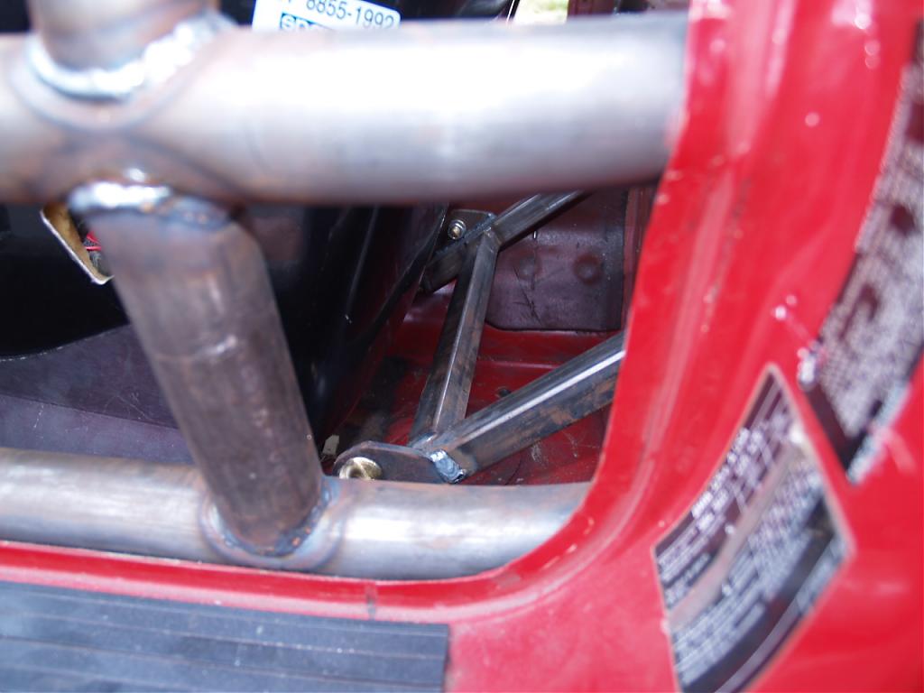

      No one even mentions using a "good" seat mounting point. How's this one look to you guys?
      • matt
        • 3732
        #33
        That is a nice seat mount.

          The NASCAR bars look really good. Most people stick them into the gutted door, not realizing that this sturcture is designed to collapse in as far as it sticks out. Yours sticks out very little, and should not pose a danger in a side impact.

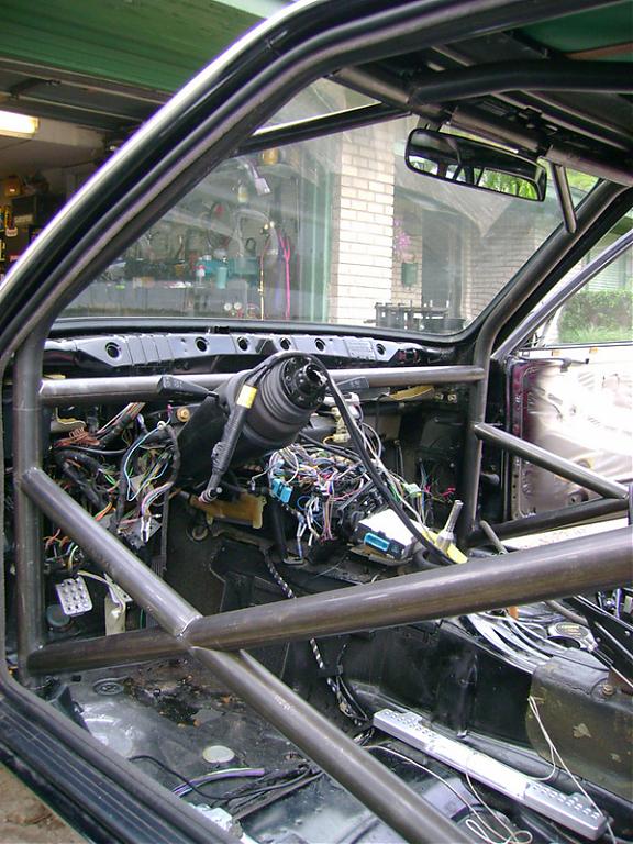

            NASCAR bars are significantly less stiff (as is the very unorthodox bar arrangement on the passenger side of the car posted above) than an X in the door frame.
            Ideally, a combination of both with some sort of energy absorbing medium would be used, but that's outside the budget of most club racers. And most pro racers.

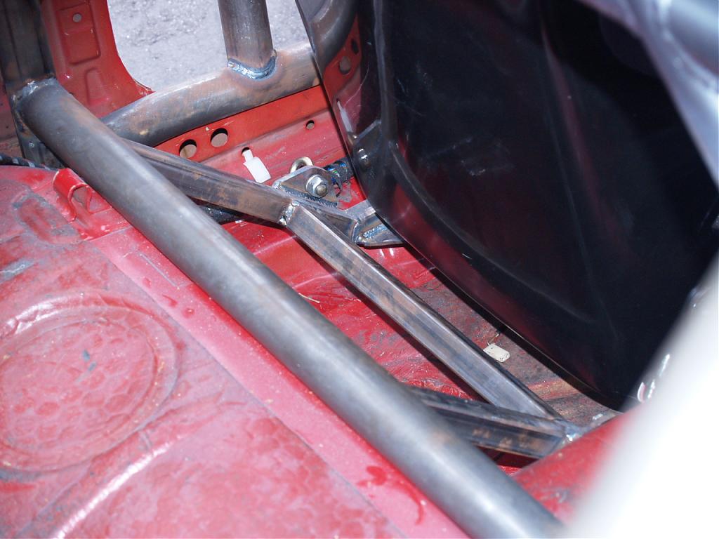

              Good Seat mount. My personal favorite would be having the seat mounted to the cage. You know where the cage is going in a wreck.

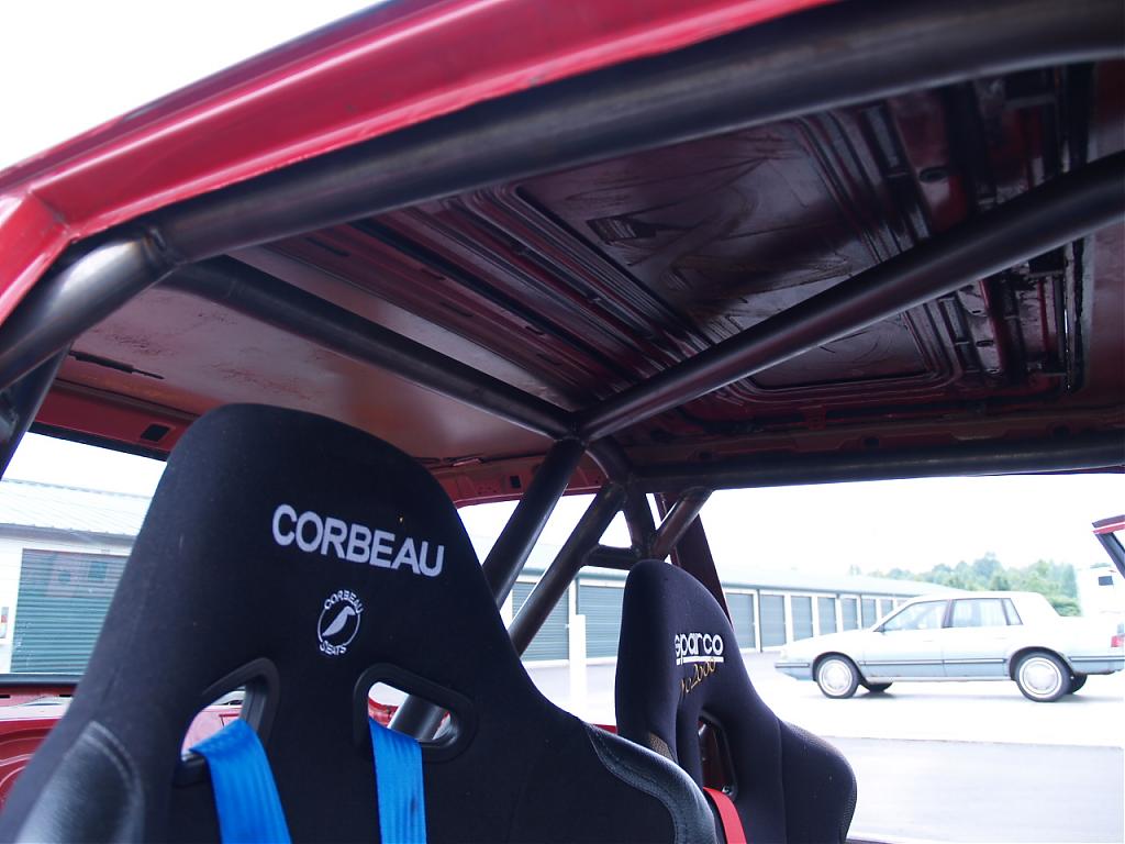

                Thanks for the kind comments! This cage wasn't cheap but both my wife and I sleep better at night because of it.
                A few more pics of it before I painted it. Seat frame is part of cage, not attached to the car. Like the builder said, it's going wherevere the cage goes! I like that!

                  #38

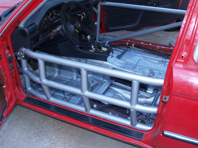

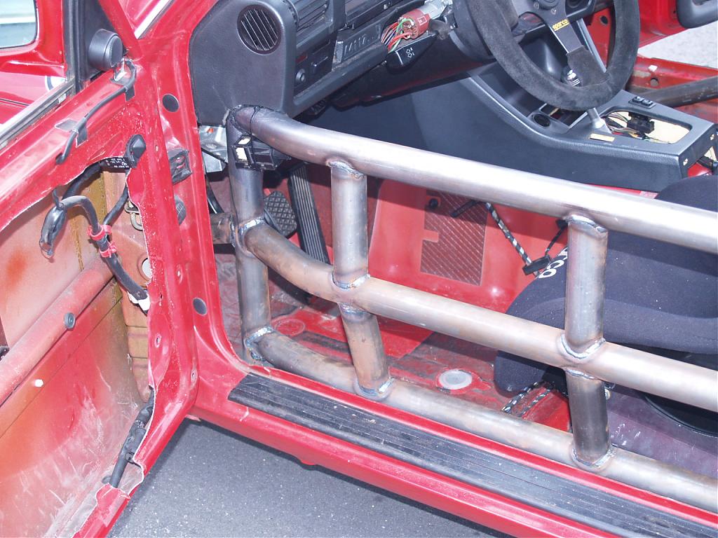

                  Wait a second, are you trying to tell me that three bars pressed outward and supported with lower one pressed (tightly) right up against the lower rail of the car itself is going to be weaker then the simple, rather light appearing X you have in your pictures?
                  Dude, I ain't no rocket scientist, but I ain't stupid either and I'm not sure I can buy that! It kinda appears to be a simple case of spin by someone promoting themself as the "Best cage builder".
                  I'm looking pretty hard at both pictures and if my A*# is on the line, I'll take "three Nascar bars to win, Alex" over the X you offer.

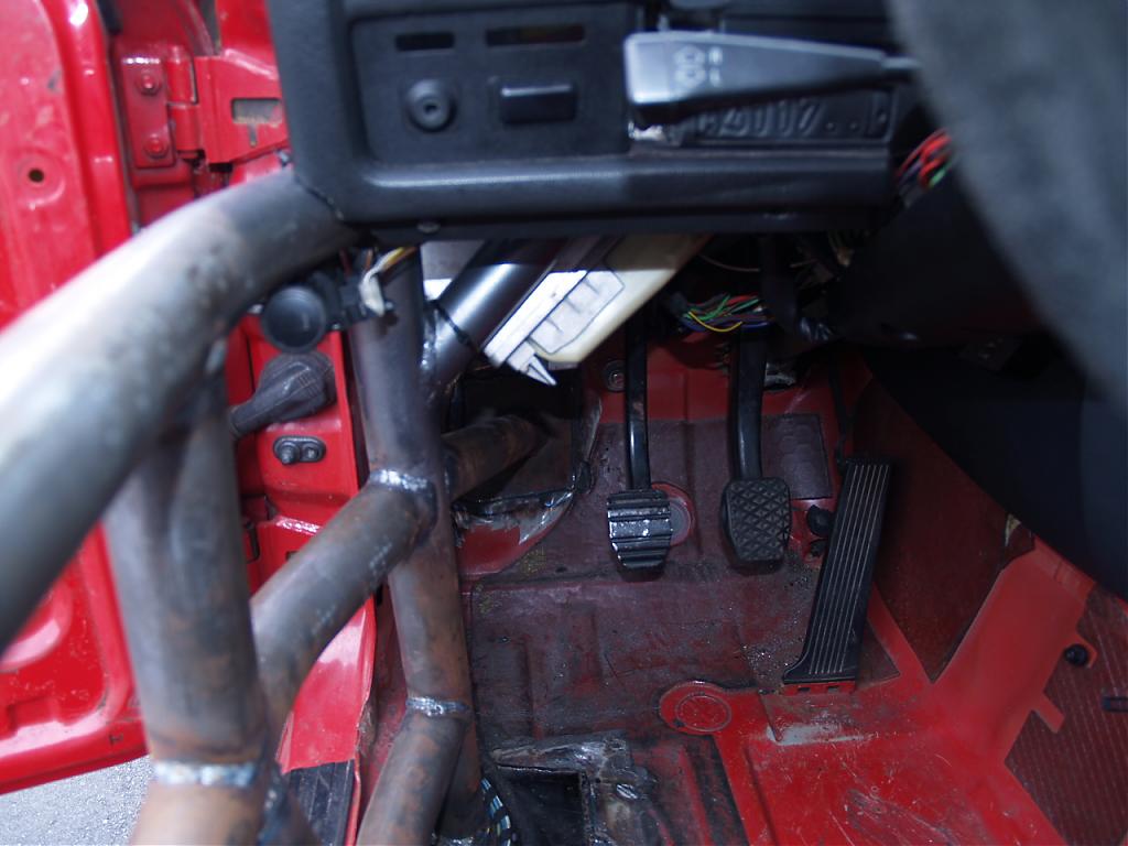

                    And here's a shot of REALLY good dash bar placement, look closely, it's where that extra (gusset?) bar goes up and it's way in there. Also, pretty nice foot well protection.
