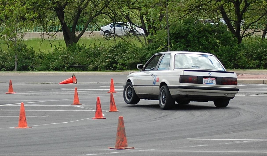

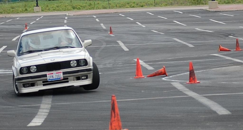

                From this past weekends event. Playing around with rear sway bar settings, after these two runs i attached the rear bar and it did not lift after that [picked up almost a full second too]

                  Damn! Joe, your car leans a LOT :) What rates?

                    HR Race, Bil sports, Vorslag CP, 21mm front bar on the strut tube. 19mm rear bar was not attached, but after i did it didnt lean as much :)

                      uh, wow - yeah, that's a bit too much lift!

                        Yeah that is a lot more then his car has done before, suprising with running "tiny" tires, but for the soft front rates that car really does handle great.
