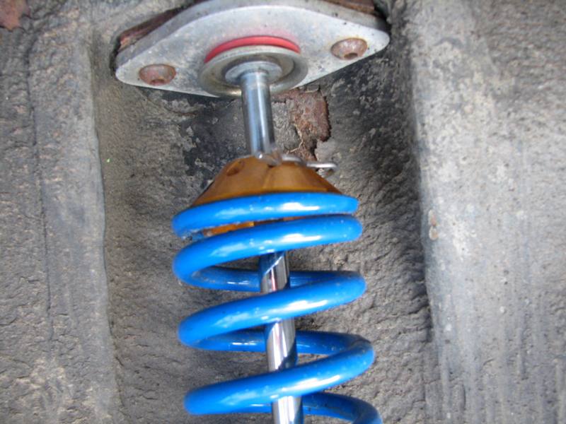

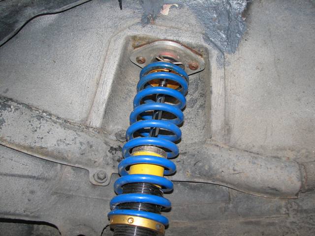

I posted a link earlier but here are some images showing my rear coilover setup. When the car is on the ground, the gap between the spring top and the top mounting point is closed. The fronts are also adjustable coilovers. With this arrangement, it is relatively easy to adjust cross-corner weights. Mine are within 15 lb with my chubby body in the drivers seat.Comment
I'm using 200 lb/in in the rear and 400 lb/in in the front. I know the rates are correct because I measured them myself. My front sway bar (Ireland Engineering 25 mm, hollow and attached to strut tower not the control arm) is set full stiff and the rear (Ireland Engineering 22 mm) is set full soft. Based on some pictures I've seen of hard right turns (turn 4 at Willow Springs), the inside front wheel is just barely touching the ground. If I changed anything, I'd go to 180's in the rear. Oh, my engine is a stock M20B25 and the car weighs 2200 lb (dry & wo/driver). If I had more power, I'm sure I'd go to a slightly stiffer front and/or slightly softer rear spring setup.

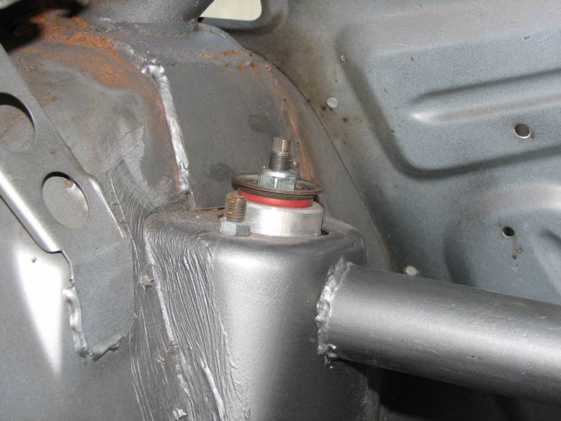

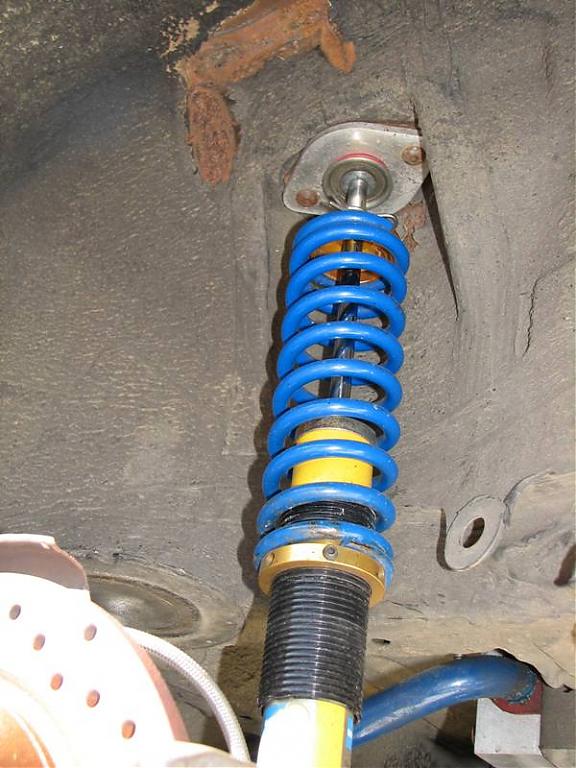

I've also taken a couple more pictures of the rear coilover setup the other day. They show tire clearance (205/50-15's on 7", ET 20 wheels) and the top of the shock with the spring in its normal position.
Finally, it's worth noting that there are springs available for this rear setup which range from 60 to 500 lb/in in 20 lb increments. Individual springs run around $50 to 60 and changing them is easy.Comment
