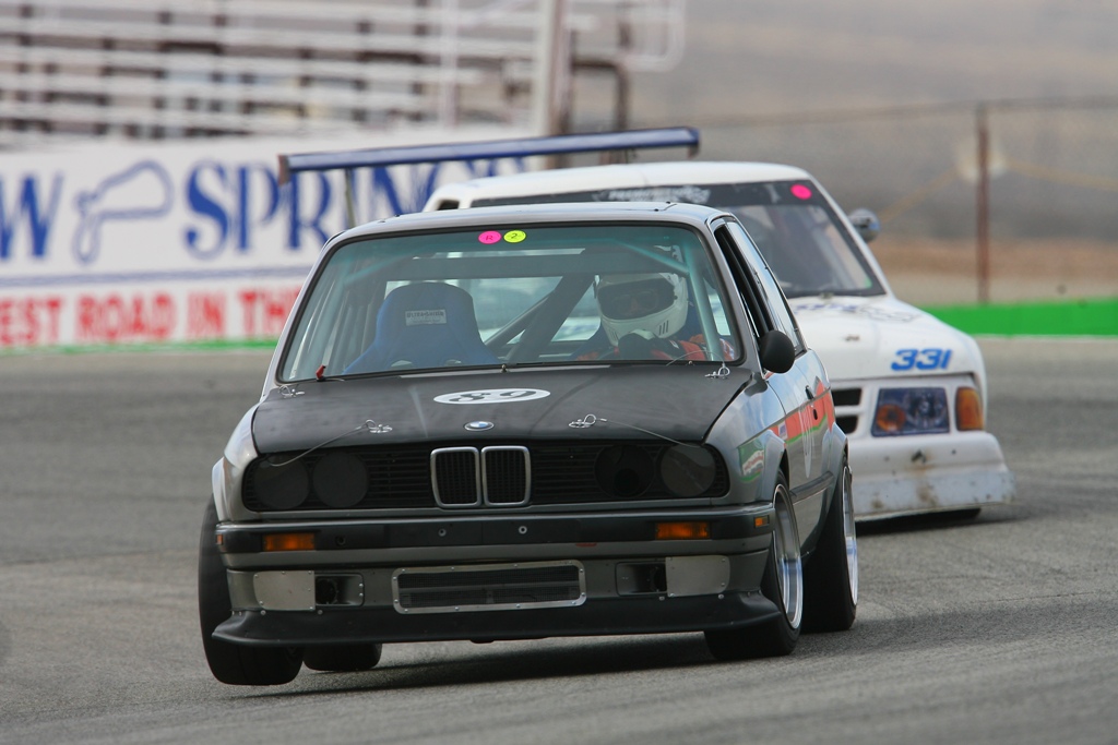

    I'm generating this thread to avoid hyjacking another one. Here's the car (there are a few more pictures in my gallery):
    The engine is a stock M20B25. The interior has been totally gutted and a full cage added. It has IE adjustable sway bars and coilovers front & rear (Bilstein Sports all around w/400 lb/in springs in front and 200 lb/in in the rear). I run whatever R-cpd tires I can get at a reasonable price. Initially it was Avon TechR's (205/50-15 on 7" rims) but a switch to Nitto NT01's (225/45-15) is in the works (price is right and they seem to work just fine).
    Things I've removed include, AC, PS, ABS, heater core, dash, interior panels, sound deadening gunk, etc. The hood is FG (IE, not pretty but functional). I pulled the most of wiring harness, just left the engine harness, and rewired everything. It now has only 3 switches, ignition, starter and brake light. All lighting has been removed with the exception of the brake lights. Quarter windows are Lexan, there are no door windows (no motors, no central locking - empty doors!). The windshield and rear window are still glass but the rear will be replaced with Lexan fairly soon. The sunroof panel will be replaced with aluminum sheet. At present the car weighs about 2250 lb wo/fuel.
    Aero is a mess on this car. The front dam is a piece of garden edging so there's no proper splitter. The spare tire well has been removed so now the rear valance is acting like a drag shoot. Once I get the weight minimized, I'll try to do something with the aero, not an easy task with an E30.
    I race the car with AROSC and with TCRA in So Cal plus I run a few autoxes with the SD BMWCCA. The car, however, is intended for racing so I doubt it'll ever be highly competitive at autox. (sorry - no video)
    I acquired the car in Oct 06 but didn't get it on the track until Jun 07. Since then I've been sorting things out. My best time at Willow so far is a 1:38.307.

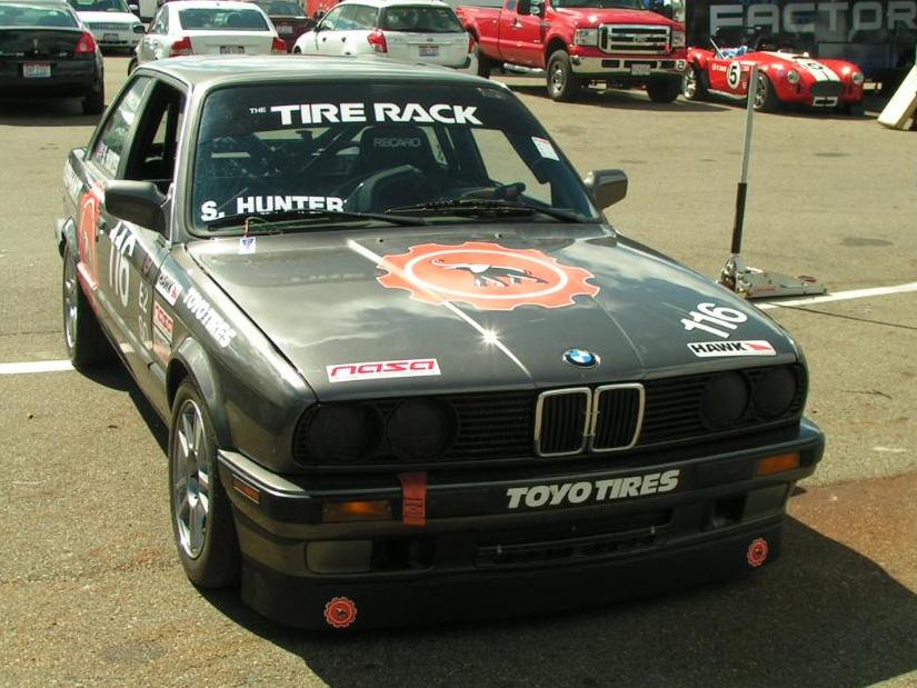

        Below is a pic of the airdam we fabricated for Simon's car at NASA Nationals last year. It's actually quite stout and a very nice piece. Utilizes a pretty stiff piece of fiberboard. We made a few of them.

          At least I know that the spring rates are correct, I measured them. I'd be willing to go a little stiffer in the front but not much. Also, keep in mind that the rears are coilovers so the springs don't need to be as stiff as springs mounted in the conventional location.
          Front bar is 25 mm (hollow bar w/solid [rod end] links), set full stiff
          Rear bar is 22 mm (solid bar w/solid links), set full soft
          The front sway bar links attach to the strut towers as they do on an E30 M3, not to the control arms.
          I guess I should mention that essentially all the rubber bushings have been replaced with urethane and that there is a strut bar in front. The cross corner weights are within 10 lb with me in the seat and a 1/2 tank of gas. The front/rear wt distribution is 52% wt front, 48% rear.
          Did I mention that it has a 4.10 LSD in the rear?
              I like the air dam but why no splitter? And have you done anything to generate down force in the rear?

                  We can't run a splitter in Spec E30.

                      I use stock E30 brake calipers. The dust shields have been removed and the front air ducts redirected a bit for improved (I hope) cooling. When I got the car, it had drilled rotors front and rear. The rears are holding up OK but one of the fronts cracked after two races. Because the other front rotor showed signs of crack propagation from the holes, I went to solid (stock) front rotors. After 3 races, they're still in good condition. Pads are Porterfield R-4.
                      To be honest, I not too impressed with E30 front brakes. The pads are a pain to change and the sweep area seems small. My last race car, a '65 Alfa Romeo Sprint GT, used stock (ATE) brakes. The fronts had about 50% more sweep area per lb of car than the E30 and I could change pads in a few minutes even when they were hot. Interestingly, the rears are about the same in terms of sweep area but pad changes are still a pain in comparison.

                            They're light weight, they make it easy to set rear ride height and adjust cross corner balance, they make changing springs very easy and they were on the car when I bought it. I've seen other ways of achieving all the things coilovers provide except perhaps having access to an abundance of inexpensive springs. Some of the alternatives look a bit contrived to me but perhaps they're necessary in order to get around a classification issue. A potential disadvantage to coilovers is that there is so much flexibility, it might be easy to get things all wrong.
