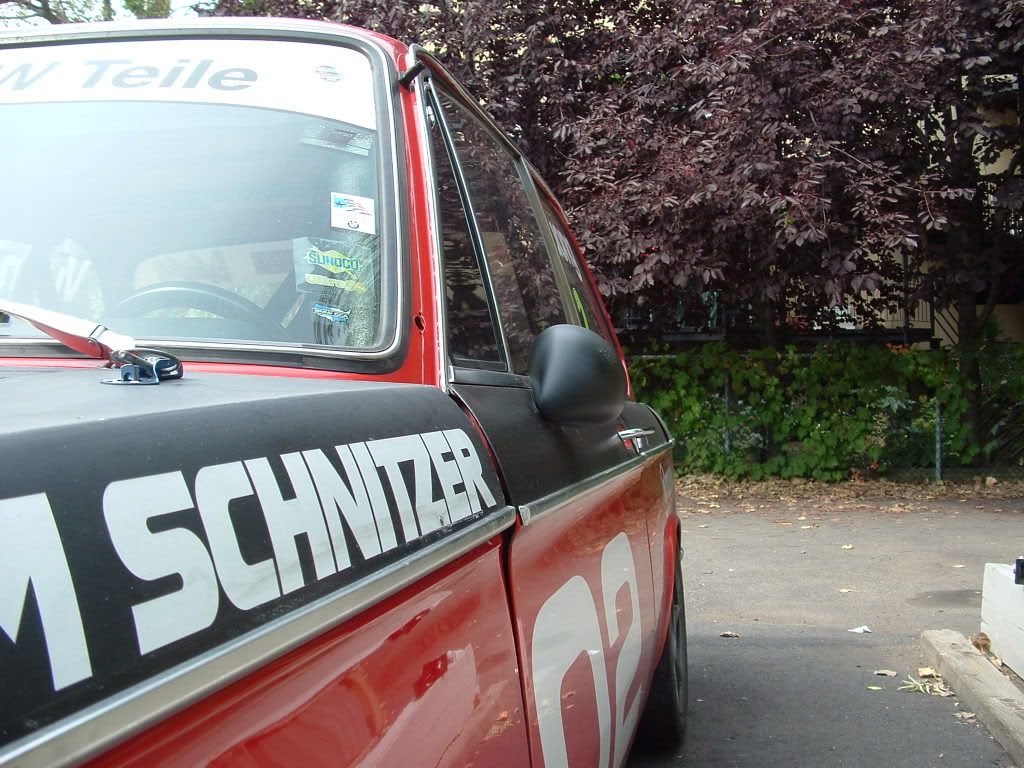

    Originally posted by Mike B. View Post
    It looks like a Vitaloni Sebring Mach 1 Mirror.
    Yes indeed. Available at Pegasus for around $80 each with flat or (highly suggested) convexe glass.
    One set initially went onto my M3, then migrated on the 2002. First e30s and M3s (1986) had these mirors but very few pictures show up on the net. Then some "modern copies" were made in composite by BMW/Die Wethje with an even more aerodynamic shape.

            Mike B. nailed it. The housing is a lightweight piece of expensive plastic but I aim it at an area I can't see in the wink mirror due to the driver's fat head being in the way.
