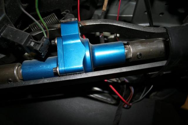

              I've seen them alternatively called a steering ratio quickener.
                me and a couple of friends have installed 2:1 ratios
                makes the car 2 turns lock to lock.
                Driving with it? AWESOME
                Drifting and any enthusiastic driving ? Equally as awesome.
                They can be had for $112 from Coleman racing products.

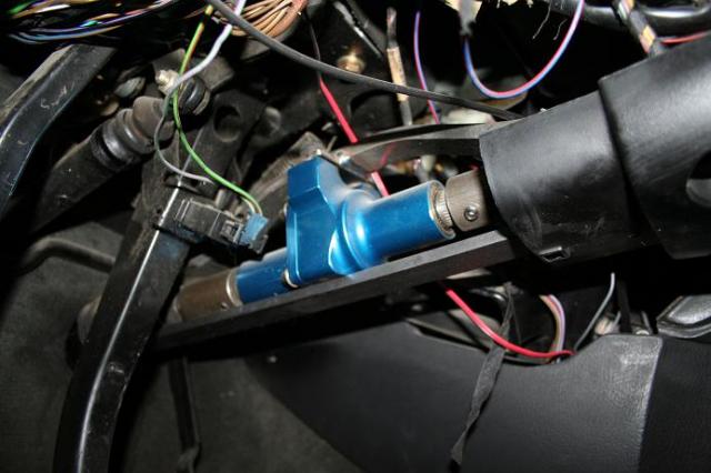

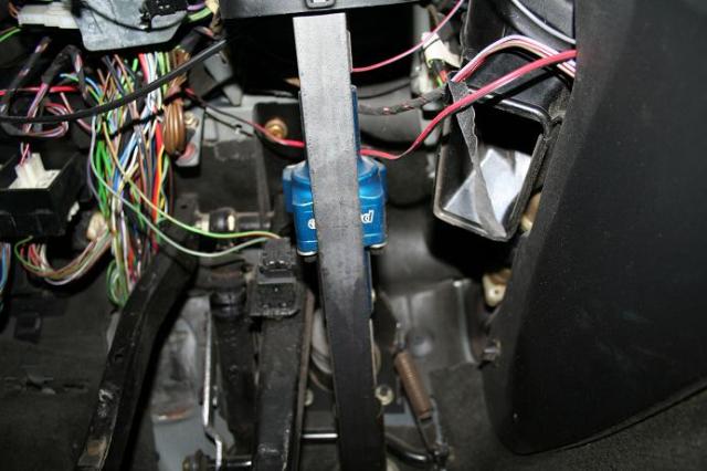

                Originally posted by The original installer in Sweden
                Since there's no room in the engine bay i took out the steering column and cut the outer tube enough to make room for the quickener and its end fittings.
                I welded 2 pieces of bar steel to make the column whole again and made a bracket to bolt the quickener to.
                then i cut the shaft and took the 2 splined ends that fit onto the quickener on the lathe and enlarged the hole so it made a snug fit on the shaft without "wobble" and welded them.
                Make sure it rotates without binding before you weld everything in place.
                And install it the right way and not backwards as a friend did...
                I´m going to recommend this, it can also be had in 1.5 ratio

                          gstuning, does the splines line up directly to stock e30 steering column?
                          did you have to weld / fabricate to get it functions properly or you bought the kit?
                          http://www.kingofeurope.net/2010/
                            read the post.
                            It tells you how to do it,
                            they don´t line up in / out but that´s not a problem when fabricated.
                            Gunni
                            @ Prodrive / Aston Martin Racing
                              Oh, nice.
                              Did you make a custom coupler to connect both ends ( top & bottom), or just use a lathe?
                              ( i'm not sure by looking at the pictures)
